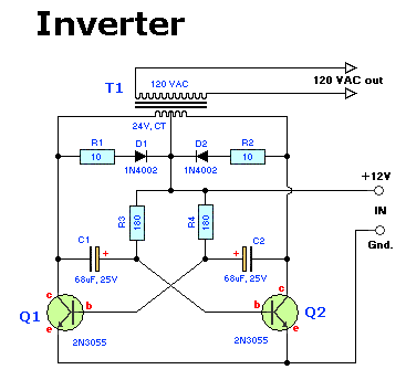

12V DC to 120V AC converter diagram ..
Sometimes you need to be specific about questions like that. Anyways, it is a hell of a lot harder to convert DC to AC then AC to DC. Above you might notice that there is an astable multivibrator circuit that is switching two waveforms 180 degrees out of phase with respect to eachother.
These are simply switching the windings on the centertapped transformer to step up the voltage to another level. I am not sure how you can make 12Vac from transformers that are readily available.. Also, do not expect a lot of current unless you are going to buffer the switching signals with some mosfets or whatever.. Your transformer needs to be able to take the power also.
