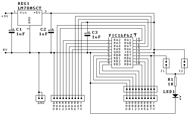

How do I get my 5v?
You may want to make you a board like this to work with your 16f627 it easy to put together on a bread board its from Nigel Goodwin site
I had the negative of the servo connected to the negative of the +5v battery cell instead of ground. (First thing mentioned by Sceadwian and again by others later) So thanks for that one !
That is what you should have, the ground, the servo negative, the 5v battery cell's negative, they should all be tied together as a common ground. the negative of the 5v battery cell = ground(or at least it should).
