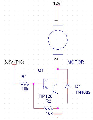

I am using a TIP120 to power up my vacuum motor that runs runs at 3530rpm with a voltage rating at 12V. The transistor's base has 5V input and a 10k resistor. The motor is connected to the collector and a 12V Lead Acid Battery. The emitter is grounded.
From what I know, when initially ON, the amount of current that flows into the motor is about as much as I expected. However, when I disconnected the base, the motor slows down and then the speed climbs and climbs until the TIP120 becomes extremely hot and the motor spins even much wilder. I believe the TIP120 has an internal diode on its own, but why does it not work the way I wanted? Hope someone can give me a pointer. Thanks!

I used a 10K resistor from B-E and a 1N4002 from E (Anode) - C (Cathode) but strangely, the problems still persist. It's a new TIP120 I bought this morning and yet it still smells like deep fried silicon after the base is disconnected. As usual, the rotation gets wilder, but it seems to build up speed slower at this time.
This is how I exactly connect the components. As far as I know, from left to right, pin 1 is Base, pin 2 is Collector and pin 3 is Emitter.
p.s: I missed out the wire from the anode of the diode to ground, but in reality I did connect them :p
The diode wants to go directly across the motor - just slide it straight up and connect across the motor.
I would also suggest dropping the valure of R1 a LOT - say to 100 - 200 ohms.

Your diode is missplaced.
Replace the transistor and connect it between 1 and 2.

Just to be clear, I think he means connect the diode between 1 and 2. :)
I'll try correcting the diode first.

Connect the diode between 1 & 2 to the nodes in the diagram or 1 & 2 of the transistor (1-B, 2-C, 3-E)?

Like BrownOut said, 1 & 2 from your diagram.

I just tried with the diodes. Cathode at node 1 and anode at node 2. The problem persists.
Then I did with a 100 ohms current, overheating still occurs, but the vacuum spins really fast but the issue with the never-ending violent spin is not there for now. Going to try that the following morning when my family is not sleeping. lol.
