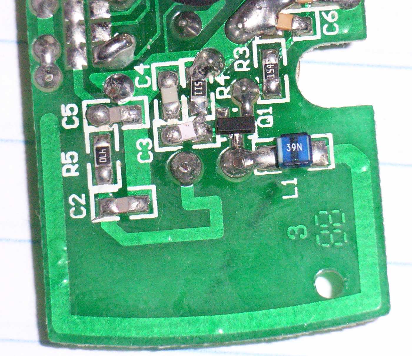

I just happen to have a 434MHz transmitter board with ~lambda/12 antenna. It's coupled by a 39nH choke from the collector of the oscillator transistor. The other squiggly trace is the RFC, which also include a deformed half-loop of wire on the other side of the PCB (for tuning?). The PCB is ~29.4mm wide, antenna (very roughly) ~56mm.
I've also heard of people using 1/4 L wire antenna loosely wound into a helix/spiral shape getting good results.
Are you sure?
Chokes are normally quite high impedance at the intended frequency, that squiggly trace will have an inductance of about 10nH at the most which is an impedance of just 27R.
Are you sure?
Yes. It's in the right spot for the RFC; i.e. C2 is to ground, R5 is to VCC (C5 to ground also).

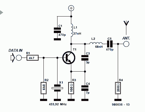

I'll have a look for the recommended RFC inductance value for the 434MHz Tx... just a sec..
EDIT: unfortunately I can't find the design note I was thinking of, but here's a snippet from an elector article from 05/98 on the transmitter bit.
Is C3 needed?
For UHF it can be omitted, the internal CE capacitance of the transistor is normally large enough.
