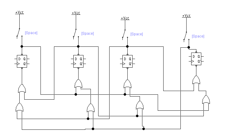

USE The flip flop, hook up button so it goes to the SET input of the flop you want to turn on, and TO THE RESET of each other flop to turn them off, so you don't cross circuits, then just hook the Q output of each flop to a relay, transistors are smaller but need a little math to calibrate
the one you have is a DUAL D-type flip flop, it should work since it still has SET and RESET,
also you will need two chips since you have 4 devices to switch and 2 flip flops per chip
acording to the data sheet the 4013 goes between 3-15V, and again just put a suiting relay across Q to ground
heree is basic schematic.....

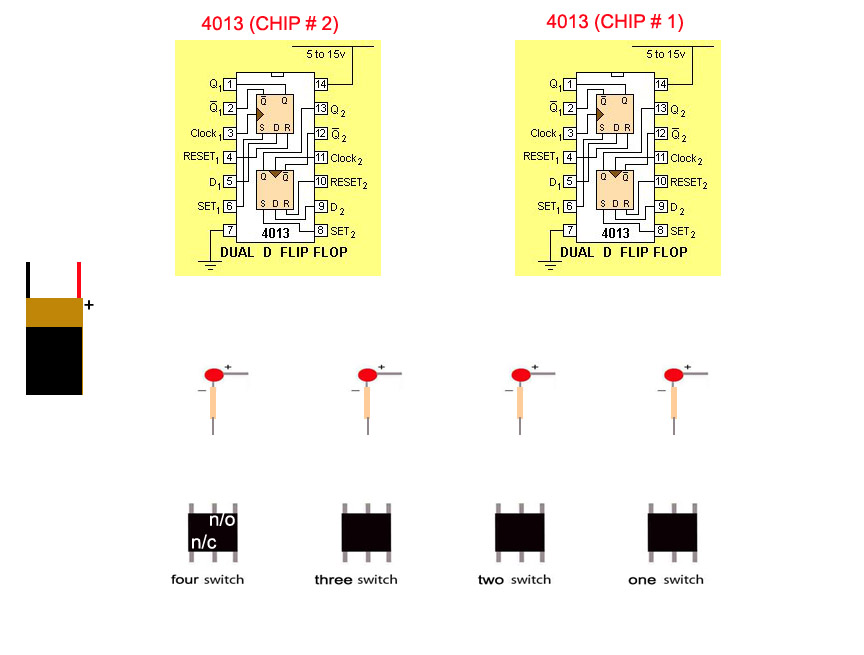

Total flip flop NEWB needs help!!
This has been a great post, and I was hoping I could find the info I was looking for here, but I am a total NEWB to flip flop circuits. I am hopeful that someone will be able to take this just one step further and complete the attached wiring layout for me. I am attaching the layout so that a helpful circuit guru can help complete the layout. The switches shown are both normally closed or normally open, depending on which solder tabs you use. I have labeled the switches n/c and n/o to show that the "LEFT" two solder tabs (top and bottom of switch as shown) are normally closed and the "RIGHT" two solder tabs (top and bottom of switch as shown) are normally open. Thank you in advance for your help.
What are you hoping to do with this setup? The OP was using a specific amp with a 9-pin socket whose contacts were temporarily shorted in pairs with some wires in common. There may have been certain voltages on those contacts, or known resistances between them which were being shunted to control internal channel-switching. Do you want to do exactly the same? If not, and all you want to do is turn on LEDs one at a time when respective switches are pressed momentarily then the circuit will be much simpler.
I want to be able to use this circuit to turn on LED's with their respective switches, and have them turn off when "ANY" other momentary switch is pressed. They will be wired to the opposite side of the switch from the amp's footswitch circuit.
This will allow me to use the circuit as a universal setup for different applications. I have searched many hours on the net for the answer to this, without success.
I also want to be able to add or subtract LED's from the circuit. In other words, if I have to wire up a single button or dual footswitch for my amp, I would like to be able to do so. If I need to wire up a 6 or 8 button footswitch, I would like to be able to do that as well.
I really appreciate any help you can offer me with this project, and I thank you, sincerely in advance for that help

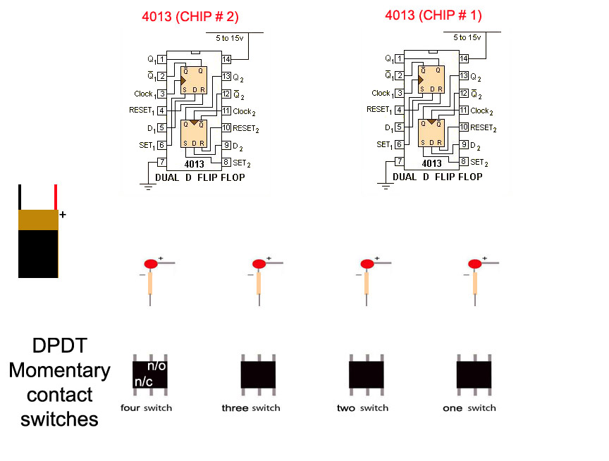

What you want looks do-able.
If you want a universal setup with expansion potential then your momentary action switches should be multi-pole types, e.g. at least DPDT. That will enable the amp switching function to be isolated from the LED switching function or any other function which might be added later.
The switches in your sketch look to be DPDT types. Do you have any particular footswitches in mind, and if so can you confirm they are at least DPDT?
Yes, they are DPDT switches, which will allow for the amp circuits to be on a separate circuit from the LED circuit at each switch. Thank you for your speedy replies. Are you the guru that will be able to complete the layout for me?

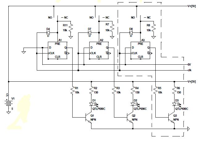

Ok, Letsneck, here's a circuit which should do what you want (at least, in simulation it does!) :-
Resistors R7, R8, R11 are pull-downs to prevent the latch inputs floating when the switches are moving between on/off.
Switch press closes the NO contacts, sets the respective latch, and clocks 0 (present at all D inputs) into the other latches to reset them (n.b. the latch being set ignores the clock signal, which is over-ridden by the signal at the 'set' input). I have shown only three stages, but expansion to any number of stages is easy; just add the components shown in the dotted outline for each extra stage. The values of resistors R2, R4, R6 shown are for LEDs with a forward voltage of ~ 2V.

OK, so because I do not see a value for the NPN transistors, I assume that any NPN will be fine. Also, there are no values for the D4, D7, and D8 diodes, so I assume any standard diode will be fine. The LED's do have a part number, but can I use any low voltage LED? Also, I prefer to use a 9 volt battery due to size constraints in my enclosure. Will that change the values of anything? Lastly, what chips are used? I am very new to logic type chips and the chips shown seem to be labeled differently from the 4013. Thank you
Any low-power NPN transistor (e.g. 2N3904), any low-power silicon diode (e.g. 1N4148) and any LED will be fine.
For a 9V supply, calculate the value (in k-ohms) of the resistor (R2, R4, R6) in series with the LED as (9-Vf)/I, where Vf is the forward voltage of the LED and I is the LED current in mA that you want (see the datasheet for the particular LEDs you use. I suggest you use a LED current less than the maximum specified, to prolong LED and battery life). Example: Vf=1.8, I = 10mA, then R = (9-1.8)/10 = 7.2/10 = .72k = 720 ohms (use the nearest standard value, either 680 or 750). The other resistor values shown are OK for 9V operation.
The chips shown in my circuit are simulated ones from the LTSpice program. The 'PRE' input corresponds to the 4013 'Set' pin, the 'CLR' input is the 4013 'Reset' pin, the 'D' input is the 4013 'Data' pin and 'CLK' is the 4013 'Clock' pin.
Make sure your 4013 is a standard 4000-series CMOS type, not a high-speed CMOS (HC) type (which can't operate at 9V).
