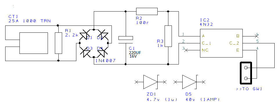

I will create a schematic with all the revisions and post for discussion. I am very greatful for everyone's help.

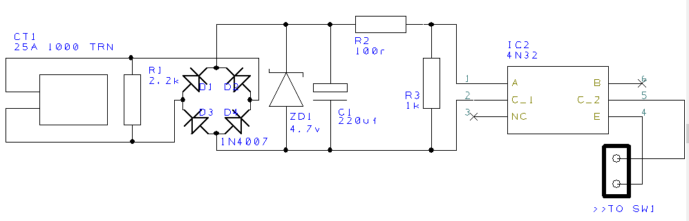

CT DESIGN 01
Not sure where to put ZD1 (4.7volt 1W) & D5 (40volt 1AMP)

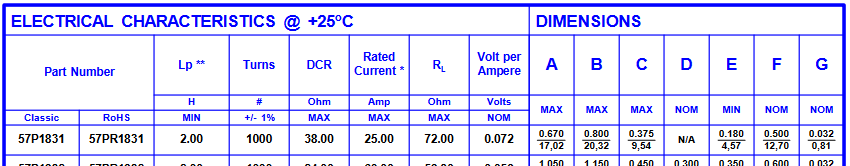

CT1 part number ( Vitec 57PR1831 )

Ill place ZD1 parallel to C1 and repost to confirm
all resistors are rated at 1Watt
the cap is 16v nothing special. if it helps i can get some BI-Polar 16v by ELNA
That current transformer has a maximum load resistance of 72 Ohms. That represents 1.8 V at the maximum input current.
The transformer is physically quite small. I think that means that the magnetic core of the transformer will saturate if the voltage exceeds 1.8 V at 50 Hz.
If you want to use that transformer, I would suggest using an AC input opto isolator, such as a TLP182 https://toshiba.semicon-storage.com/ap-en/semiconductor/product/optoelectronics/detail.TLP182.html. You could connect the input of that straight to the current transformer.
A resistor can be added in parallel to alter the current at which the TLP182 turns on.
The TLP182 output is DC, and you would need a DC power supply, which would be switched by the TLP182, to turn on the 4N32.
