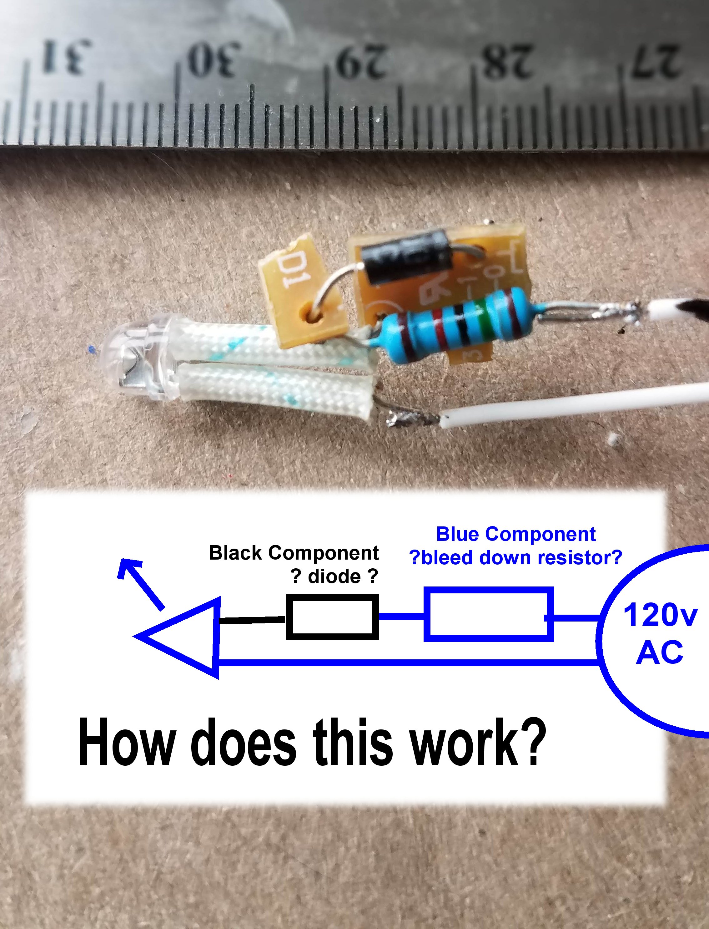

How does this work? Its black magic. LED working from 120v AC
Why a resistor in the first place? I use a 400 Volt AC capacitor with the LED's connected in 2 "anti parallel" chains to do the same. The Capacitance depends on the "resistance" [ 1/(2*pi*f*C)] required.
like this (with 6 LED's)
cool. thanks everybody.
The problem with using a diode and resistor to make a power supply for higher power LEDs is the resistor has to dissipate MUCH more POWER.
Like you asked - 6 x 1W LEDs - (2v and 500 mA), requires a 300 ohm resistor and that resistor will need to drop about 20 watts RMS. Make sure you have a good heat sink on your resistor and some ventilation to circulate that heat.
If you use a bridge rectifier instead of a single diode, you can still use a 300 ohm resistor to keep the max current through the LEDs below 500 mA, but the full wave rectification bumps the power on the resistor to about 40 watts RMS.
Good luck.
NOTE: the use of a diode and resistor is not a "well kept secret" as you suggest, but usually a stupid design if more than a few milliamperes are needed.
Another option for powering LEDs is called a capacitive dropper. The resistor is replaced with a capacitor and the reactance drops the voltage. The capacitor on this situation must be rated cor greater than the peak line voltage (i.e., 1.414×line voltage).
Use caution with either type circuit - they are live at line voltage. This type of power supply can be used to power a microcontroller circuit but if this is done, the entire circuit and anything connected to it is live at line voltage. The entire circuit must be isolated from any chance of contact to a person.

I was looking for the smallest simplest way to power an LED from USA household current which is 120 volts AC. At the dollar store I found an LED night light and opened it up expecting to see a tiny transformer or something to power the led but instead I found this: <see attached picture>.
I am dumb founded how to explain how this works, and when I checked online for led's powered by 120v ac nothing comes close to this circuit I found. Mean while, it works perfectly. What is going on here?
The resistor limits the current, the diode provides half wave rectification so the LED mainly gets a DC current although it is still pulsing. If you shake it back and forth you may even be able to pick up the blinks because it only lights up for 1/2 cycle.
This design does not look like a true professional design although it may work anyway.
Problem 1 is that the resistor is rated for 1/2 watt yet the power dissipation is 0.48 watt so the resistor may get very hot. You could check that.
Problem 2 is that the reverse voltage across the LED is dependent on the capacitance of the LED vs the capacitance of the diode. They are banking on the LED having much higher reverse capacitance than the diode. That's almost definitely true, but i dont think it should govern the overall design and there should be a reverse connected diode across the LED too or the LED may one day blow out.
