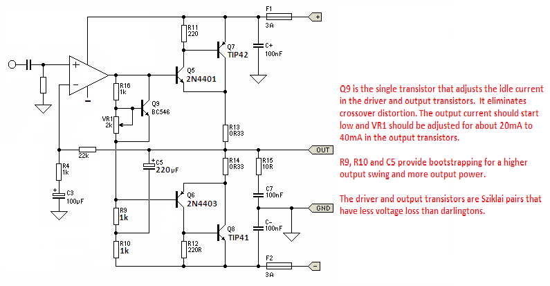

Now I know what people mean by crossover distortion...It sound fine at lower volumes but when it get's up there in power you can tell the distortion some....I need to build that biasing network...I have tried it before but it attenuated and made the output sound horrible, is there a particular diode I should use or is anything okay?

You would need 4 diodes to cancel the base-emitter forward bias voltages of the 4 transistors but a single transistor and two resistors can do it and even be adjustable. The diodes or single transistor can be mounted on the heatsink of the driver or output transistors to cancel "thermal runaway" (current causes heat which causes more current which causes more heat over and over until destruction. But the diodes or single transistor turn on more when they get hot which brings down the current and heat.

Can you explain how to do it with a single transistor and two resistors?

I joined together a couple of amplifiers to show you how to make your amplifier:
that makes sense. My distortion was comming from my source I figured out. Thanks for the schematic I want to try it..
