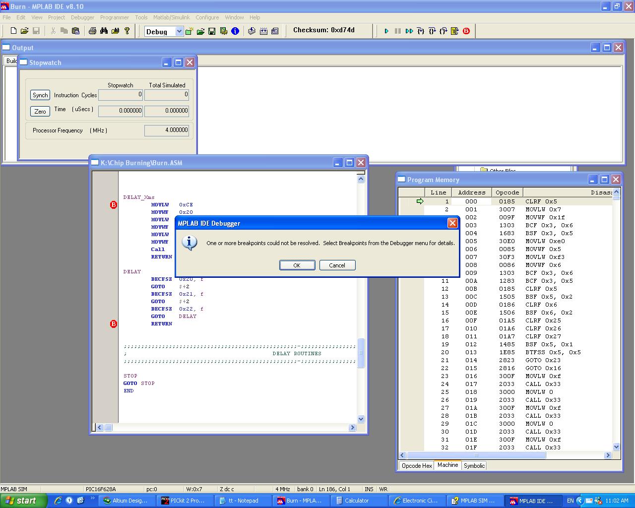

Use the simulator and stopwatch in MPLAB. Place a breakpoint on the first and last lines. Hit F9 and zero the stopwatch at the first breakpoint. Hit F9 again and see how many cycles it takes.
Ok I found it.
I've set the break points,
But I get an error when i hit F9...
That error is normally because you put the breakpoint on a line with no instruction or you have inserted lines in your code and not reassembled. Try reassembling and running again.
