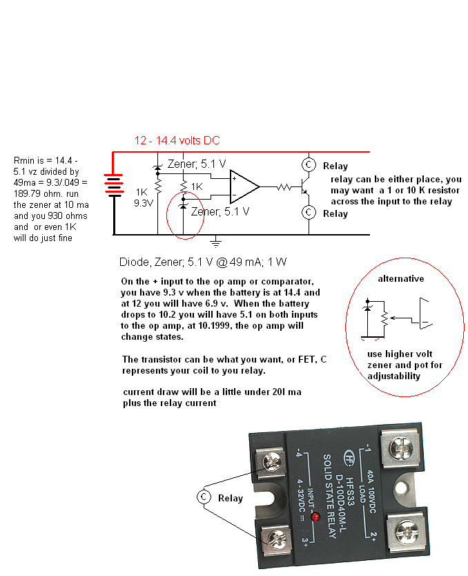

Kinarfi can you elab. on the diagram above? what component are you using? i might use one of these
Relays - Solid State - SSRDC100V40A and a very simple circuit can control it, of coarse i would need to alter your 5V up to like 10V
The 5 V was the zener, see drawing. Looked up the specs on the zener and saw no min current, you could probably use 10k load resistors for even lower current drain.

ummm these say they are low resistance solid states,7mohm so how long would a 2.3 amphour battery last holding this closed with this circuit? i failed with my v=i*r
im sorry, i should have been more clear, which op amp are you using? is it the lm339?
either one, no feed back so the output will be at the max or min
ohhh and is that just a PN2222
npn?
pnp or npn will work, looked at the specs of your SSR and it draws 28 ma at 32 v input, probably safe to assume 1/2 or less at 12 v
by the way thank you!!! i like how simple this just got. :)
You're welcome
The 7mohms is on the output - the input draw at 12V is probably around 10 ma, a 50 cent LF356N, a 44 cent LM393N or 17 cent LM339, about 2 ma, and using 10K resistors you would have around 2 ma for a total of about 14 ma.
about a weeks worth of continuous on. Flip the op amp/comparator over so it is off and turns on at low voltage and it would run much longer.

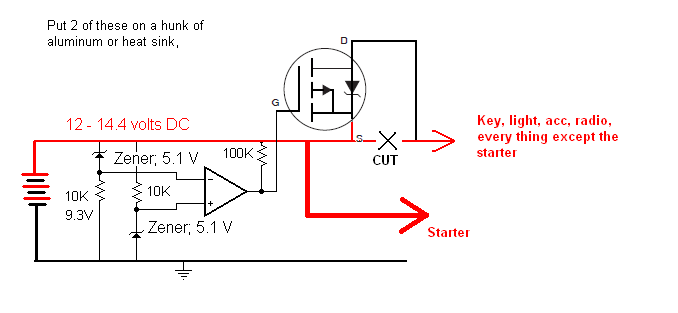

No, no secret, just don't want a battery to go below set voltage... Ie you leave the lights on, you just turn off the lights wait a sec and then you crank it over
What type of circuit are you using? , this will be a simple design
mount 2 IRF4905 FETs with insulation to a heat sink or a piece of aluminum and butt splice a #14 or #16 copper wire to each lead of each FET and tie Gate to gate, source to source and drain to drain .
The output of the op amp will be low until the voltage drops below 10.2, then the output goes high and turns the FETs off. Each FET is rated for 72 amps and I doubled them but doubt I need to.
Assuming one heavy wire to the starter and a #12 or #10 to the rest of the vehicle or if Chevy and you have the connection block on the fire wall, cut the wire and tie the battery side to the source and the drain to the other side going to the vehicle. Tie the gates to the output of the op amp. The resistor from source to gate is to turn the FET off when the output from the op amp goes high.

leave enough wire to bypass if all fails and throw a wire nut in your glove compartment. Ha ha.

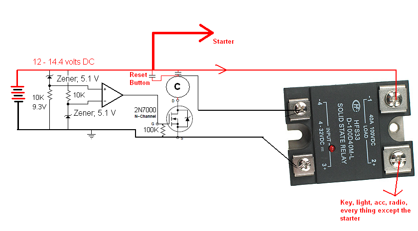

Well, I am going to use the one above with the op amp driving the ssr. I thought we had already got this worked out. Do you think this system is insufficent?
I'm still going to want to use the relay, I want to start it off the circuit. I just wish there was an even more effiecent relay, or a high side design with sufficent terminals for ~40A
Mr. Pita,:D here's my last suggestion/thought for you to consider. You need something to drop out and lock out if your battery runs down, I suggest a small signal mechanical relay with a button to reset it. For the sake of example, let's say you left your lights on, as the battery pulls down to 10.2 volts, your lights will go out, the battery will start to regenerate and your lights will come back on. With a mechanical relay that holds itself in, once it drops out, it will stay out.
BTW, your 40 amp relay with nice terminal probably cost twice what the fets would have and 2 fets would carry 3 times the current and you probably still need a heat sink.

this is EXACTLY what i want, so basicly, what is happing, is the circuit is operating up to the 10.2, then the system drops out, and will not turn on until a momentary is touched and resets the system.
thank you Kinarfi!!!!and just for FYI, the fet is like .25 cents and the SSR is $21 :( but this is what i want to do.
THANK you again! this should be great!
i dont think that your reset button will work as you have it drawn:confused: EDIT: Nevermind... i see you have it open at the cap now
what µ cap should i use?
