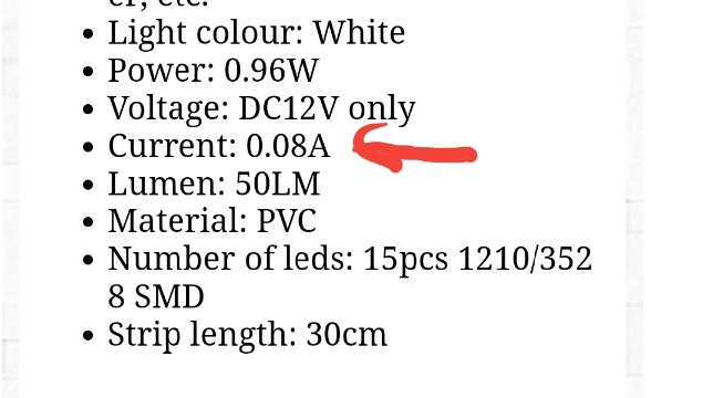

"...just 12v LEDs...." is missing a key detail. An important consideration is the current draw of the LED strips. The listing for them isn't entirely convincing in its details, but the important part is this. The specifications are:
Power = 0.96 watt
Current = 0.08A
Number of LEDs = 15
I believe the spec is for power and current draw per LED, so the entire strip draws 0.08 × 15 =:1.2 amps.
How many strips are you using all together?

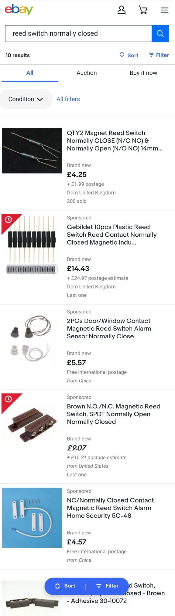

Regarding reed switches, if you follow my schematic, the reed switches are switching a tiny amount of current. Ebay's UK site has many suitable normally closed reed switches.
That would seem to make sense. When I power one strip directly from the bench power supply it reads as pulling about 1amp so that must be right.

So I need to find a Magnetic Switch capable of pulling an amp or a little more in order for this to work simply?
I have found an alternate in case I can not get this to work. The equivalent method would be using a mortice switch - again used in cabinets for lighting - so if I could not source the correct items I could always revert to these, though again I understand they would need to be able to pass through a certain amount of current to work I believe the standard ones are enough.
