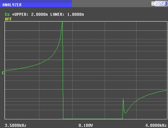

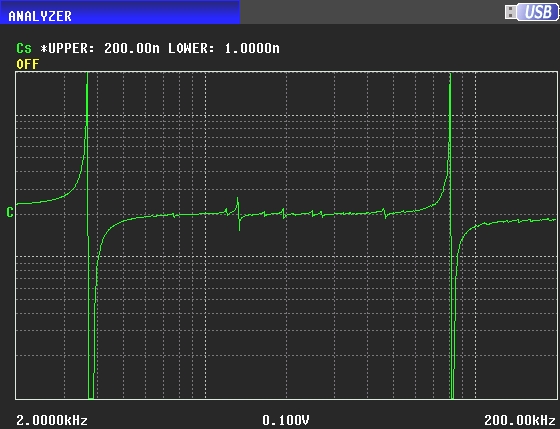

I have measured the apparent capacitance of a piezoelectric bender of the type used to make the beep sound in portable electronic devices and attached a couple of plots.
The first plot shows the apparent capacitance over a frequency range of 1 kHz to 100 kHz. You can see two major resonances, and a number of minor resonances. Notice that the apparent capacitance varies from 1 nF at the bottom of the plot, to 200 nF at the top. Actually, the variation is greater than that.
The second plot zooms in on a narrower frequency range of 3.5 kHz to 4 kHz. The apparent capacitance varies from about 43 nF at the left edge of the plot (3.5 kHz) to 2 µF at the peak (approx 3.67 kHz).

Your Tenma measures the capacitance at a relatively low frequency; it is to be expected that the apparent capacitance rises with increasing frequency as you approach resonance. You should find out at what frequency those capacitances were measured.
