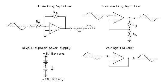

so, its a voltage follower I need?
Here's what I found:
Voltage Follower:
The voltage follower, also called a buffer, provides a high input impedance, a low output impedance, and unity gain. As the input voltage changes, the output and inverting input will change by an equal amount.
__________________________________________________________
Do I wire it up exactly as the pic on the bottom right.
It neads +5 and -5 volts supply to it, yeah?
Voltage Follower:
Yes, it's the bottom right diagram, and I would recommend that you use a +/- supply. One problem you may have is that the opamp may not go fully to +5V, even a rail to rail opamp may not be 100%.
If you check my analogue PIC tutorial you will see that I use an external 2.5V reference, so the opamp only has to output between 0V and 2.5V, this prevents any potential problems! - it also makes the conversion more accurate and repeatable.

No, I'm saying use +/-5V supplies, but use a 2.5V reference on the PIC, this way the PIC input is from 0-2.5V, rather than 0-5V, which is well within the range of almost any opamp.
I see.
But, A.F.A.I.K. the picaxe programmer will not allow 0-2.5v reference.
There is no command for this feature with the Picaxe's basic laungage code.
Can only use the Picaxe's supply voltage as the reference supply.
