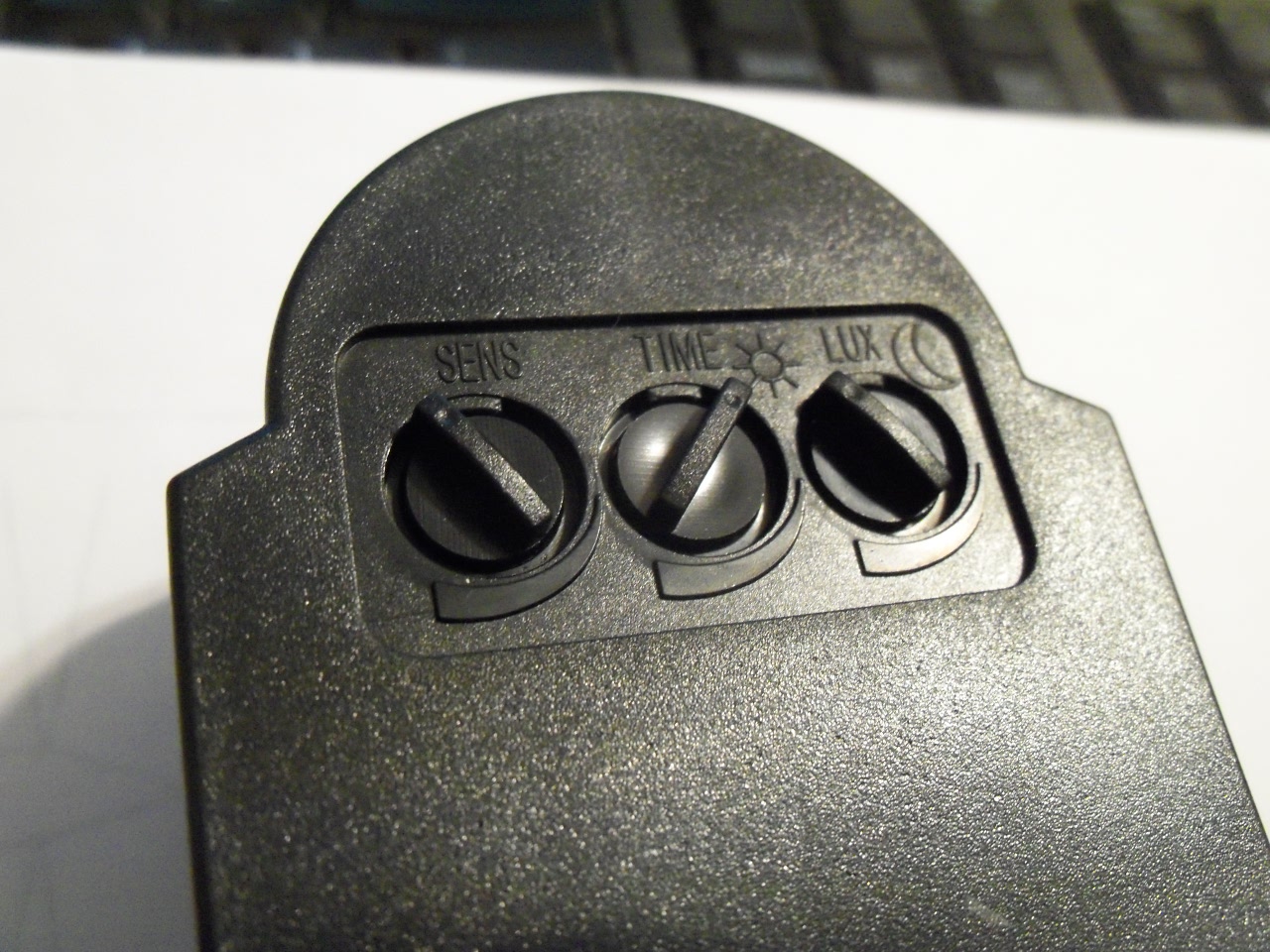

WHAT is LUX? Online says, light intensity. How does that apply to motion sensor it has no control over how intense light is? I don't understand LUX?
Industrial lights are best, Lumens, volts, watts. I bought 4 industrial lights 7800 Lumens, 120 vac, 70 watts. Motion detectors that I already have are 2 years old, 2 went bad. I bought a new motion detector from California it has 3 adjustments instead of 2. I know SENS is sensitivity, TIME is timer, but what is LUX with picture of a moon? These lights are bright as the sun. Yard stay dark all night until we go out or someone drives up. I had to take wife to hospital 10 pm the other night I sure am glad I have these lights.
Like most outdoor PIR lamps or light switch, has a light sensor - the "lux" control sets sets the light level threshold that allows the PIR part to switch on the light, so it does not come on during the day when it's not needed.

After more than an hour of online searching I learn LUX can be use in the middle of the day in full sun to set off a siren or loud bell or cameras. It can also prevent light from coming on in middle of the day.

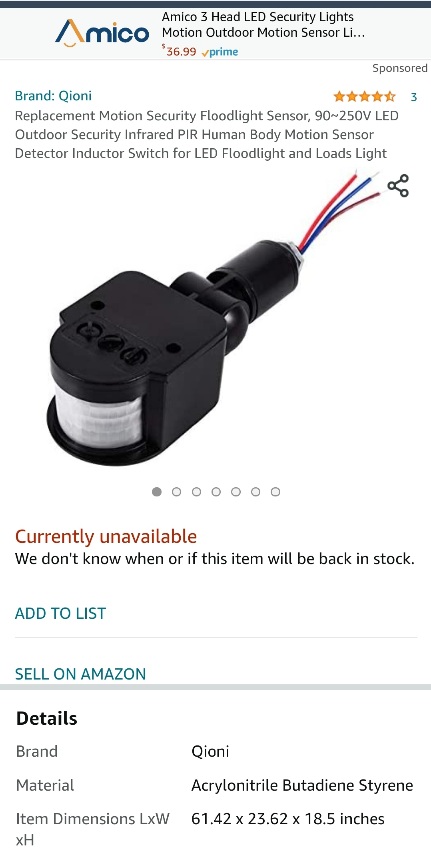

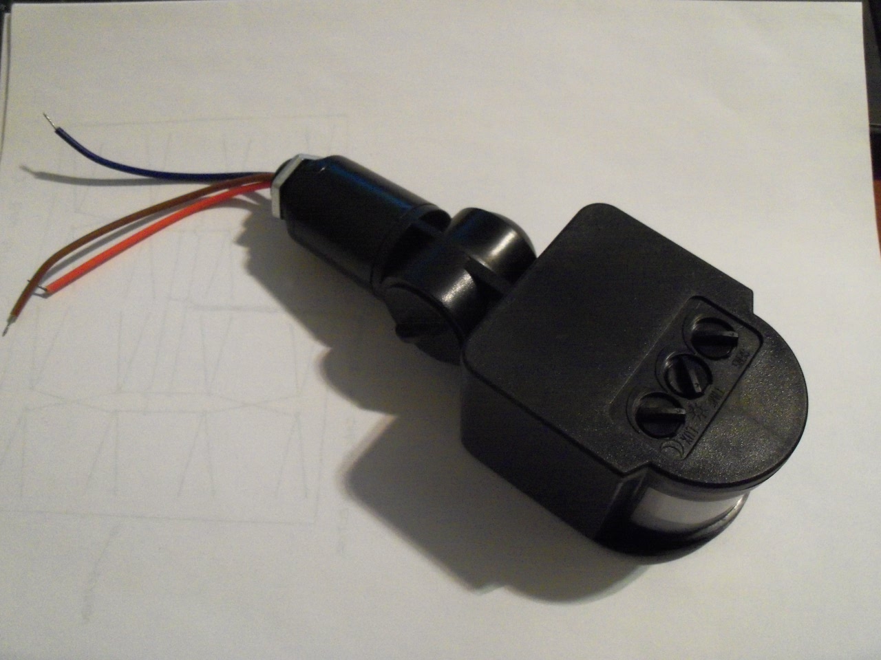

There is NO circuit drawing. Which wire is 120 vac? Which wire is ground? Which wire goes to the light bulb? It has, brown, red, blue wires. My other PIV units have, black, white, red.
I may need to remove a motion sensor from the side of the house to figure out which wire is which. It might be easier to drive to Lowe's or Walmart remove motion detector from box to see which wires are which. I'm not sure without checking but I think red might go to the light bulb? Not sure about brown & blue wire.
I sent seller a message about circuit drawing they don't even know what that means. They keep asking for clarification. I ask which wire is 120v reply is, piv is 110v. I ask which wire is ground reply was, if you have any more questions we be glad to help. Idiots probably have no clue what they are selling.
There are only 3 wires, I can guess and figure it out but if first guess is wrong it might fry the unit.

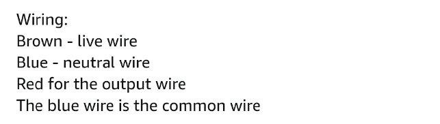

By the way, brown = live, blue = neutral is the standard European color code, so this isn't an arbitrary decision by "idiots selling unmarked junk to fools."

This motion detector unit has strange threads I have never seen 9 threads per inch measures almost 9/16" diameter. I had to make thread adaptor to convert it to 1/2" NPT. Threads might be metric? None of this was in the sales advertisement & no way to know thread size looking at a picture. This is no different than going to Walmart and asking what thread size is on something they sell, SALES people don't know they are only sales people. If I did not have tools the average person does not have someone else would have assembled this with JB Weld or Epoxy or maybe duct tape. My bad motion detector light is repaired & now ready to be installed. This was a learning experience and almost not worth $7 with free shipping.

Actually, the wiring is according to the standard European color code. But the key point is that I found out the information with literally 30 seconds of Googling with nothing to go on but the picture you posted. A simple "thank you for finding it" would have been a nice token gesture.
If you never saw 9 TPI how did you make the adapter?
Or are you one of "those " people?
I worked as a machinist, Tool & Die maker for several years & I have my own ChurchHill Lathe & BridgePort mill in the garage. My thread gauge said 9 so I set the lathe to cut 9 threads per inch. I miced the diameter then cut the threads to fit. Aluminum made this a very easy job.
