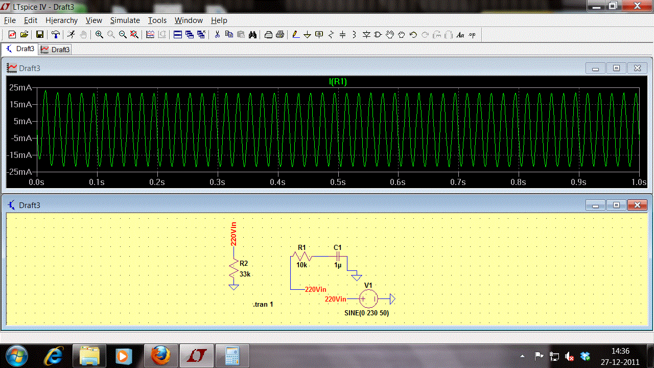

i calculated current in RC series network to be 2mA , but spice is giving me current to be 42mA
can anybody verify
can anybody verify
At 50Hz the Zimp of the series RC is 10500R, so 220Vrms approx 325Vpk gives ~30mA according to my calculator.??

The Directive in your Vsrc says 230V not 220V
that was 42mA peak to peak , so rms current is 29.702mA
How did you calculated Xc reactance ? i calculated it by 1/2.π.f.c , which is 0.0314/c (f=50)
taking C= 1 x 10^-6
Xc= 31400 ohms

yes thats what i said
so Z= √ 10k^2 + 31400^2
then Z= 32953 ohms
then current I= V/Z .... 220/32953 = .00667 Amps
or 6 mA but LT spice is giving me 40mA peak to peak which is 30mA RMS. what is going wrong ?

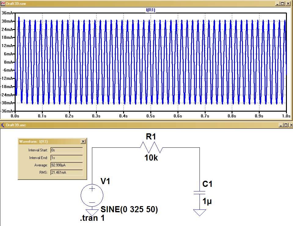

Xc= 1/( 2 * pi * F * C)
1/(2 * 3.142 *50 * 1 * 10^-6)
1/0.000314
= 3184R not 31400R
so Z = √ (10,000)^2 + (3184)^ 2 = 10,494R
so Irms = 230/10,494 = 21.9mA RMS
which is not 30mA RMS given by LTspice , why dont you try this circuit on your simulator
I have already pointed out that you are actual using 230V not 220V as your SIM.
The point you are missing is that LTspice, in the Directive expects Vpk, so for 230Vrms you need the directive to state (0 325 50)
I have tried your sim with the correct Voltage
