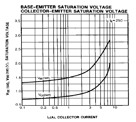

The TIP121 datasheet specifies Vce(sat) with forced beta=250. For Ic=1.4A, you need Ib=1.4/250=5.6mA. Typical Vbe(sat) at Ic=1.4A is, from the graph below, about 1.6V. (4.8V-1.6V)/5.6mA = 571 ohms. Use 560, the next lowest standard value.
