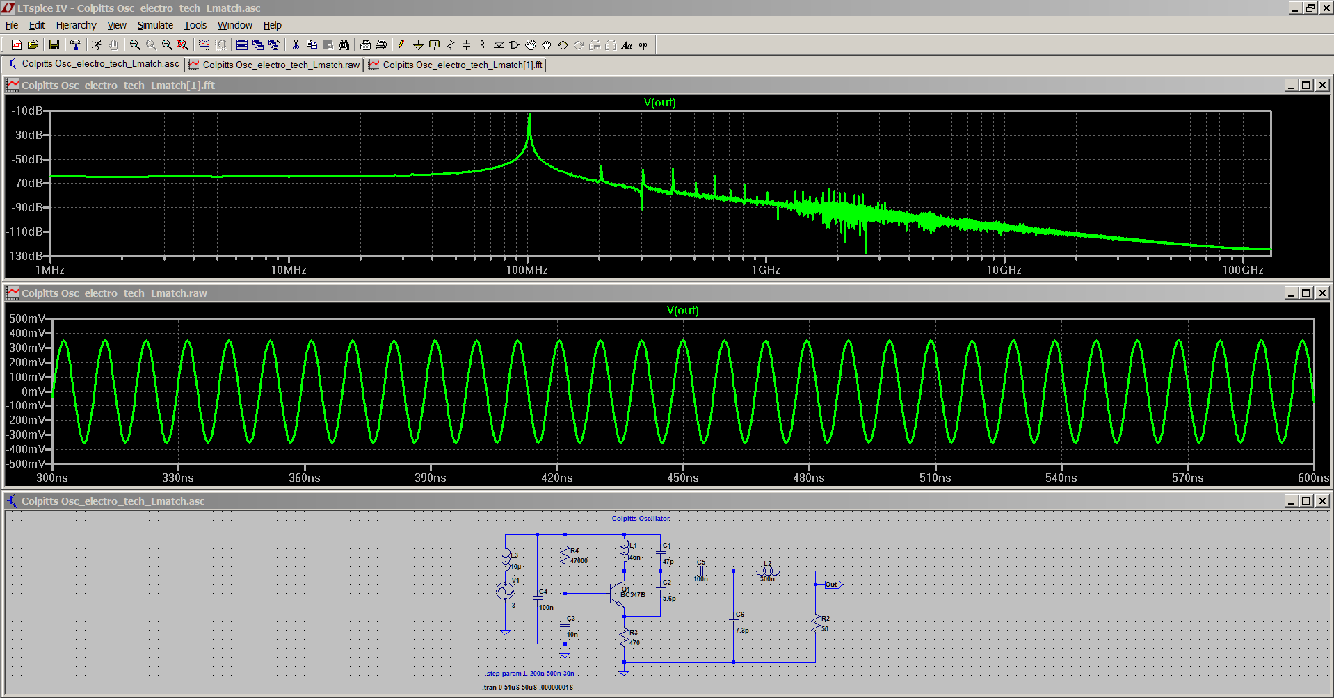

Can you please, help me in the calculation of input and output impedance of the following circuit:
This stage operates as the oscillator in a FM transmitter, and I want to put a matching Pi network between it and the 50 Ω antenna, so I need to calculate its input and output impedances.

Yes, the oscillator is Colpitts type with common base transistor amp. The output of the first stage changes the base bias of the osc transistor, thus slightly changing the equivalent capacitance of the transistor, thus changing the oscillator frequency (and the amplitude slightly, too).
BTW, I modeled the oscillator in LTSpice for fun. The output impedance of the model is 700-j200 at 100 MHz. You can use that as a starting point to match the oscillator to 50 ohms using a conjugate matching network and expect about 1.5 mW output power, and its stable (for wideband FM operation, anyway) . If the matching network you use has a DC path to ground at its input (such as through an inductance and/or resistance), use a 10n or larger capacitor between the output of the oscillator and the matching network to block DC.

Attached is a screen-shot and LTSpice .asc file. As for determining the output impedance of the model, I used a bit of trial and error with the simulation. We know that the output impedance is roughly 470 ohms (emitter resistor) and capacitive (roughly 9 pf). So, I put a 470 ohm load resistor in series with enough inductance to counteract the capacitive reactance and connected the series combination to the output of the oscillator through a 100n DC blocking capacitor. Next I did a parameter sweep simulation of the inductance and selected the inductance that gave the greatest output current through the load resistor. Next I did a parameter sweep of the load resistor to find the load resistor that provided the greatest peak output power (700 ohms). The output impedance is determined by calculation from those two values and the frequency of operation (700-j200).
In the attached model, I matched that output impedance to 50 ohms using an L matching circuit, calculated via on online calculator.

The output swing is only 0.33V peak which is 233mV RMS. Then the output power into 50 ohms is only 1.1mW which is almost nothing.
If the 50 ohm antenna is connected directly to the collector of the oscillator transistor then the oscillator probably will not oscillate.
Add an RF amplifier transistor to isolate the oscillator from the antenna. Then the frequency will not change when something moves toward or away from the antenna.
Like this?
but when simulate it I found that the inductance that gave the greatest output current through the load resistor = 500nH, and the current = 2.25mA

The collector load does apply, but the collector load in the circuit at issue is a LC resonant tank with a very high impedance so it is insignificant. A perfect resonate tank has a theoretically infinite impedance. The emitter resistor must apply because the oscillator current flows through the emitter resistor too.

Yes, that's what I did, only I get 550 ohms, not 100 ohms, so you might want to run that again.
That's still different than the 700-j200 I mentioned previously. I can only assume I had a different transistor in the model when I figured the output impedance of 700-j200 and then put the BC547 in there later. I was experimenting with different transistors at the time and I probably got my models confused. But, what you describe is how I came up with the output impedance for the model. Sorry for the confusion.

You did good. I used the following site to figure the matching network from the output impedance.
https://bwrc.eecs.berkeley.edu/research/rf/projects/60ghz/matching/impmatch.html
Edit: Wait a minute. I just realized you didn't look at peak power when you did a parameter sweep of the resistor value. You are looking at current. To plot power hold the Alt key down and left click on the resistor.
