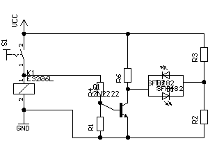

there are more then one type of multiclor leds,
some are red/yellow, red/green, green/yellow....
it depends how they are connected, some are connected antiparalel and some have 3 pin capsuple sharing an anode or cathode....
so you want to have a led that is, let's say red when the sw it off and green when the sw is on?
o, i understand wht you want now, but is the led with 3 pins(common anode or cathode) or with 2 pins?
i got an idea for the 2 pin led...

yes, that is the simplest way, Paul, but i thought he has a simple toggle switch..
if he can modify it and gut one like you said that it is very simple to do the work.
Well, got everything done, and I used Paul's idea.
thanks for everyone's help.
