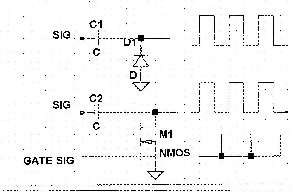

Hi all,
I would like to know How i can control Base line voltage of a an electric pulse.
Regards
Here are some ideas, do a Google search for "DC restore circuit" for others.
