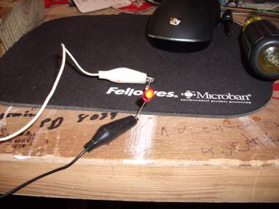

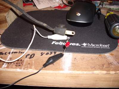

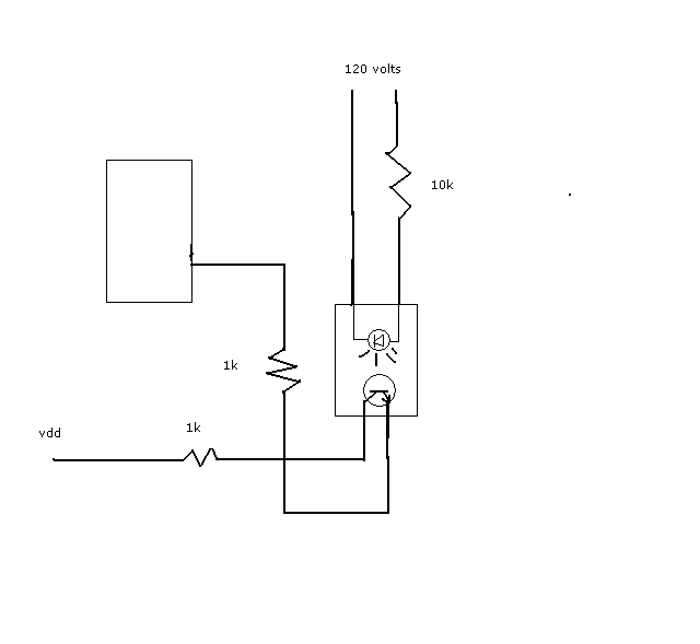

just to put a little light on it here some thing to think about you can use a Optocouplers for isolation and resistor for current limiting. and feed it 120 volts
now we can't look inside a Optocoupler so I just use a led so you can see that
it's not going to hurt your Optocoupler.
I think you'll find the the reverse breakdown voltage of the LED in the optoisolator is something less that 120v x 1.414. Placing a 1N4003 across the LED, and opposite the LED polarity will solve that problem. The resistor will have to be a 2W...dissipating 1.44 W.
But that works.
Ken
I think it a little less then 1.44 W. more like 422.5 Milliwatts but any way I let it stay on for a hour with just a half watter 10 k and it didn't get hot You no phone's have them Optocouplers in them to pickup the ring-signal AC wave it can be up too 90 volts
Hey be80be - the circuit you've drawn cant possibly work, the sense wire coming off the emitter will never sit at anything but ground potential.
