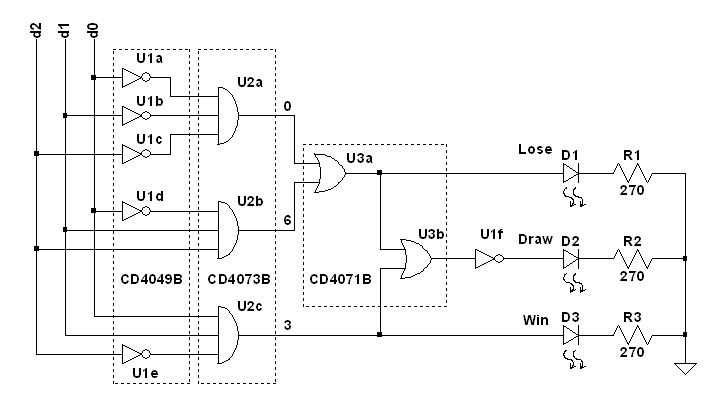

Here's how I'd do the logic to get drive signals for 'win', 'lose' and 'draw' LEDs, using just 3 ICs. In practice the gate outputs won't provide enough current for a bright display so buffering or latches would be needed :-
