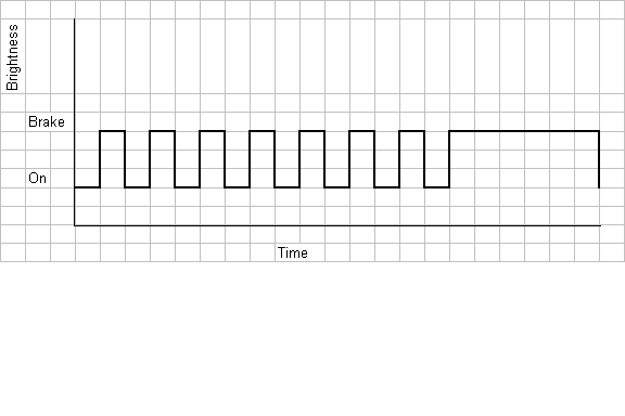

Tail light
Is this what you want it to do?
I think we are confused. Do you want it to flash (blink) when you put the brake on?
No problem. So here is what I think you want.
1- When lights are on the tail light is on.
2- When brake is on tail light flashes brighter for maybe 15 times.
3- After flashes brake light stays on but stops flashing.
4- When brake is released brake light goes off but tail light stays on.
Is it correct?

3- After flashes brake light stays on but stops flashing.-Yes,then will continue flash until i released my brake...
Let see>>>I press my brake,tail light will flash 15 times(more faster is good)>>stop flashing but light stays on maybe 1 or 2 second>>>>Then continue flashing>>>stop flashing>>flashing....until i released my brake...
When i released my brake,tail light is still ON but no flashing....
I hope u understand..thank for help..
