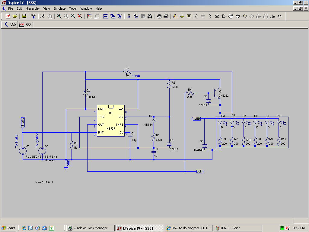

Yes a 555 will maybe work, but a few more questions.
I understand your LED's have resistors. You want to use 6 so we need to know how much current or power each one uses. We may need more power than just a 555.
We need to know if the signal to your lights is the negitive side of the battery or the positive side. Usually it is the negitive side, but we should make sure. In other words, is the +12 volts always at your lamps now and ground is added by the brake switch to turn the lamp on?
I think we will make it so they always flash when the brake is on. It is easier.
Ok sir...
For LED,i think is use around 0.5 watt or less
On my socket bulb for tail light,have 3 wire...1 for Engine ON,1 for Brake and another 1 for ground...
So i think,i want use wire from Engine On to link each LED,and same time 1 wire from Brake will link each LED also..
"Y Concept",That means..2 wire will connected then join each LED...So u think must use DIOD 5408??
Or u have any idea??thank for help sir..

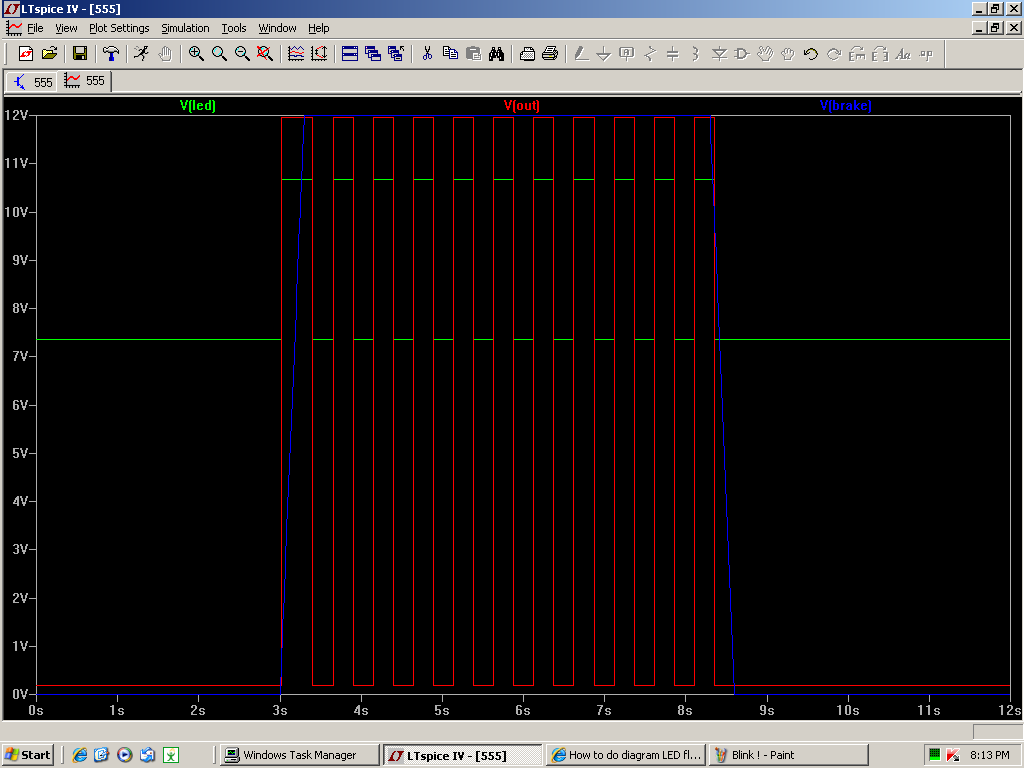

Blink
Try this. Hope it is what you are looking for and that it works ok.

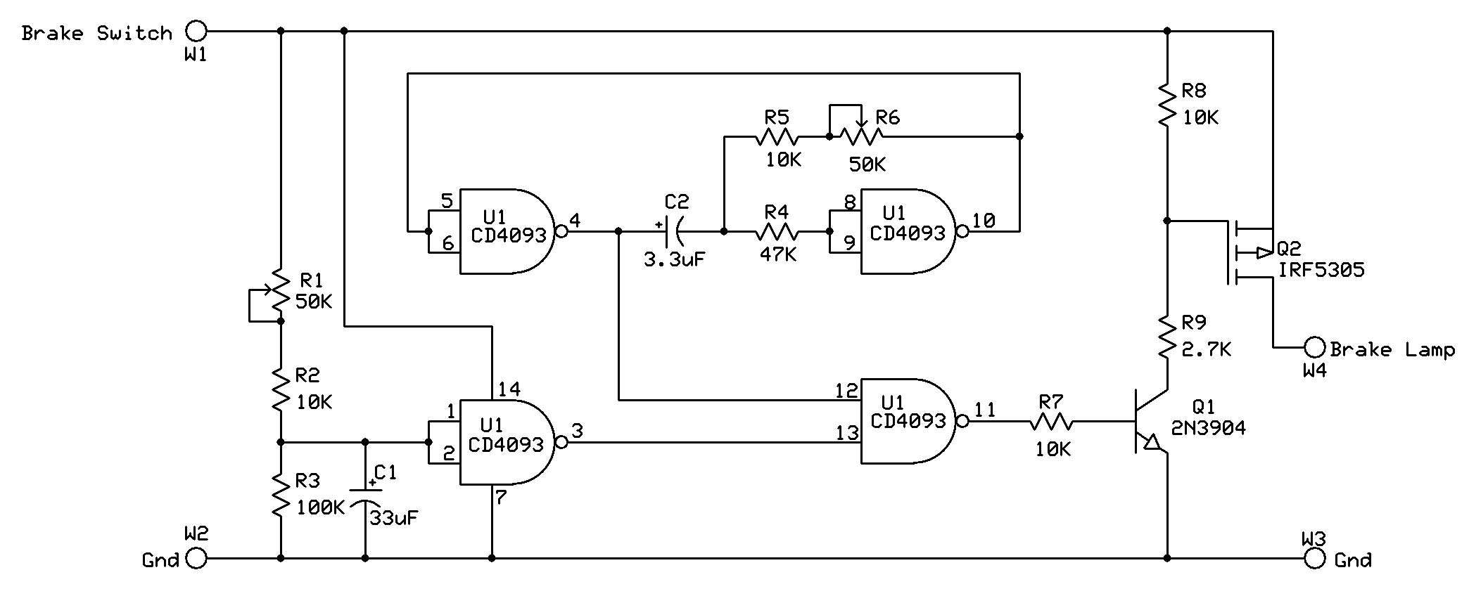

Here's mine, that I've used in three different vehicles. Flashes several times, than stays on. Adjustable flash time and rate.
Ken

The Brake Light circuit can be simplified to this:
**broken link removed****broken link removed**
U1 is an integrated circuit: **broken link removed**
Q1 is an NPN bipolar transistor:http://www.fairchildsemi.com/ds/2N/2N3904.pdf
R6 and R1 are trimmer potentiometers, similar to: Bourns 2.5MegΩ 3/8" Square Trimming Potentiometer-The Electronic Goldmine
Q2 is a P-Channel Power MOSFET: http://www.irf.com/product-info/datasheets/data/irf5305.pdf
We used different approaches to achieve the same end result.

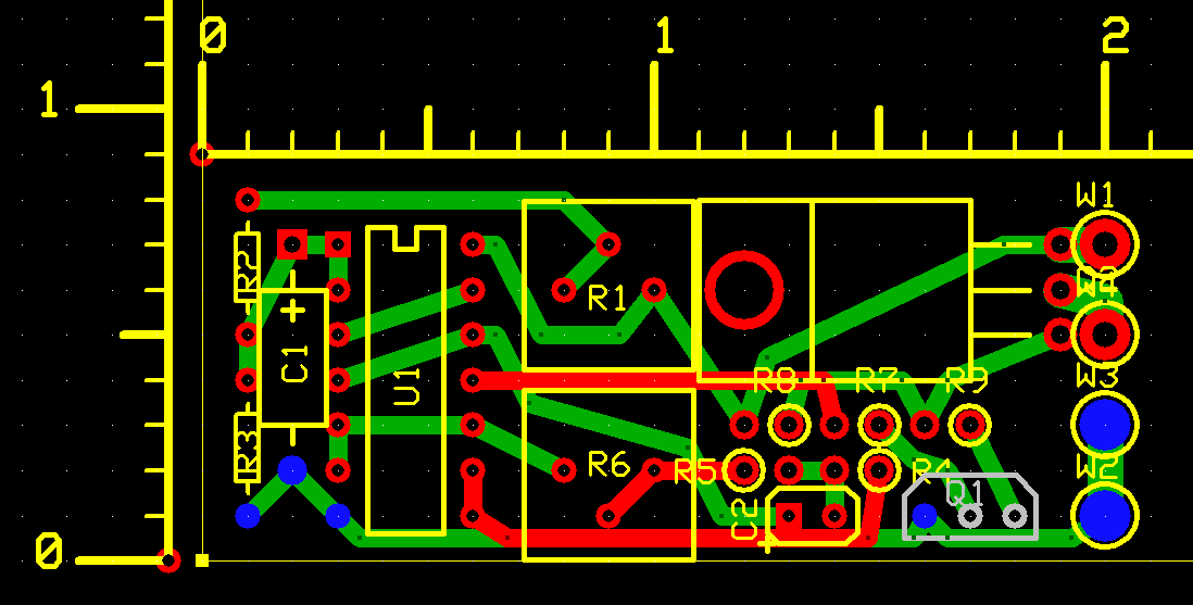

Attached is the layout for mine on a PCB program, but is proportioned sized for a 0.1" x 0.1" perf board. That's what I actually used, with point-to-point hand wiring.
Ken
Thanks! An insert error. The original was a darlington.
Corrected schematic attached.
Ken
