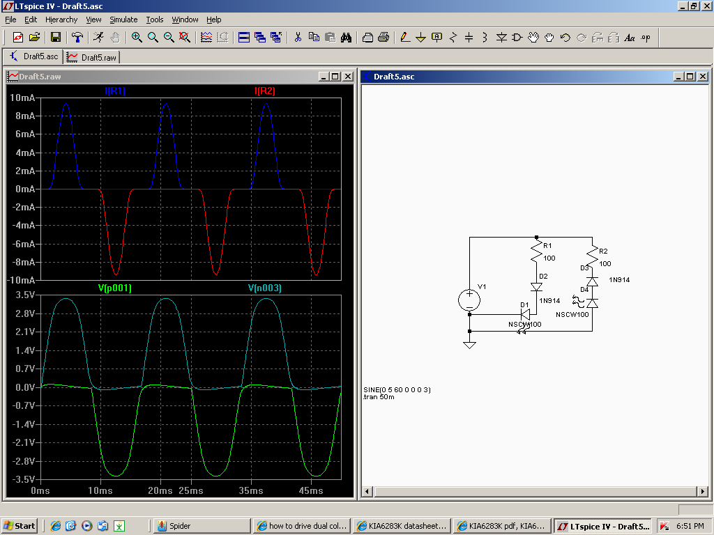

Is something like this what you are looking for?
Oops, missed the common cathode part.

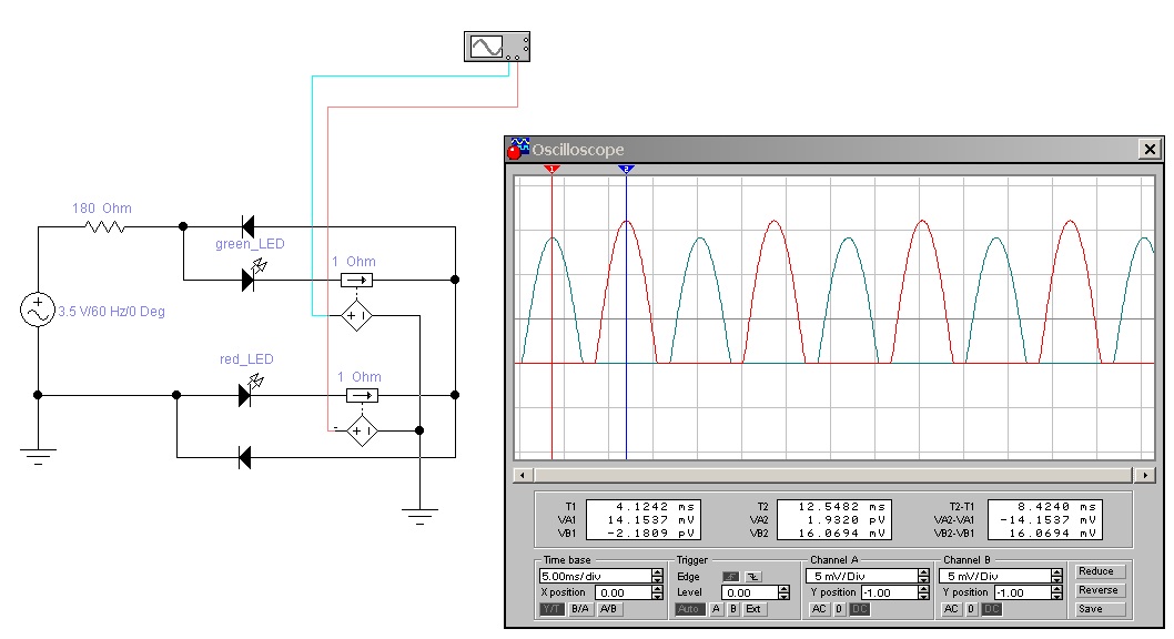

All you need are two rectifiers and a resistor.
Connect the AC source to each LED anode. Connect a rectifier in inverse direction in parallel across each LED from the LED's anode connection to the common cathode connection (with the appropriate resistor in series with one the AC connections to limit the LED current to the desired value).
That way the LEDs will alternately light, one on each half cycle with the rectifier carrying the current around the LED that is reverse biased.

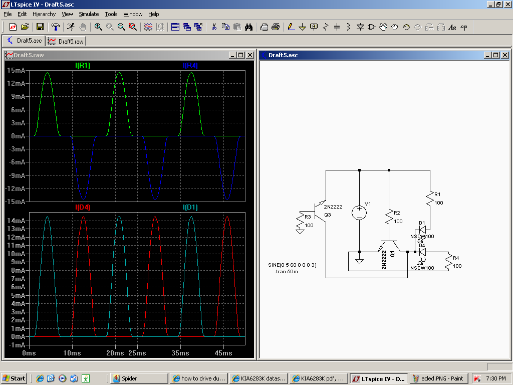

OK, Here is another one. Might need a tx with higher Vbeo than the 2N2222.

Here's a simulation of the two rectifier diode, one resistor circuit. The oscilloscope shows the currents for the two LEDs (1mV = 1mA). Notice that each LED lights on alternating half cycles of the sine wave input.
Edit: Changed voltage source from 10Vrms to 3.5Vrms (10Vpp).
The difference in current between the two LEDs is due to the difference in forward voltage between the red and green LEDs. If this is not desirable, then you could use two different value resistors in series with each LED instead of the one resistor in series with the source.
