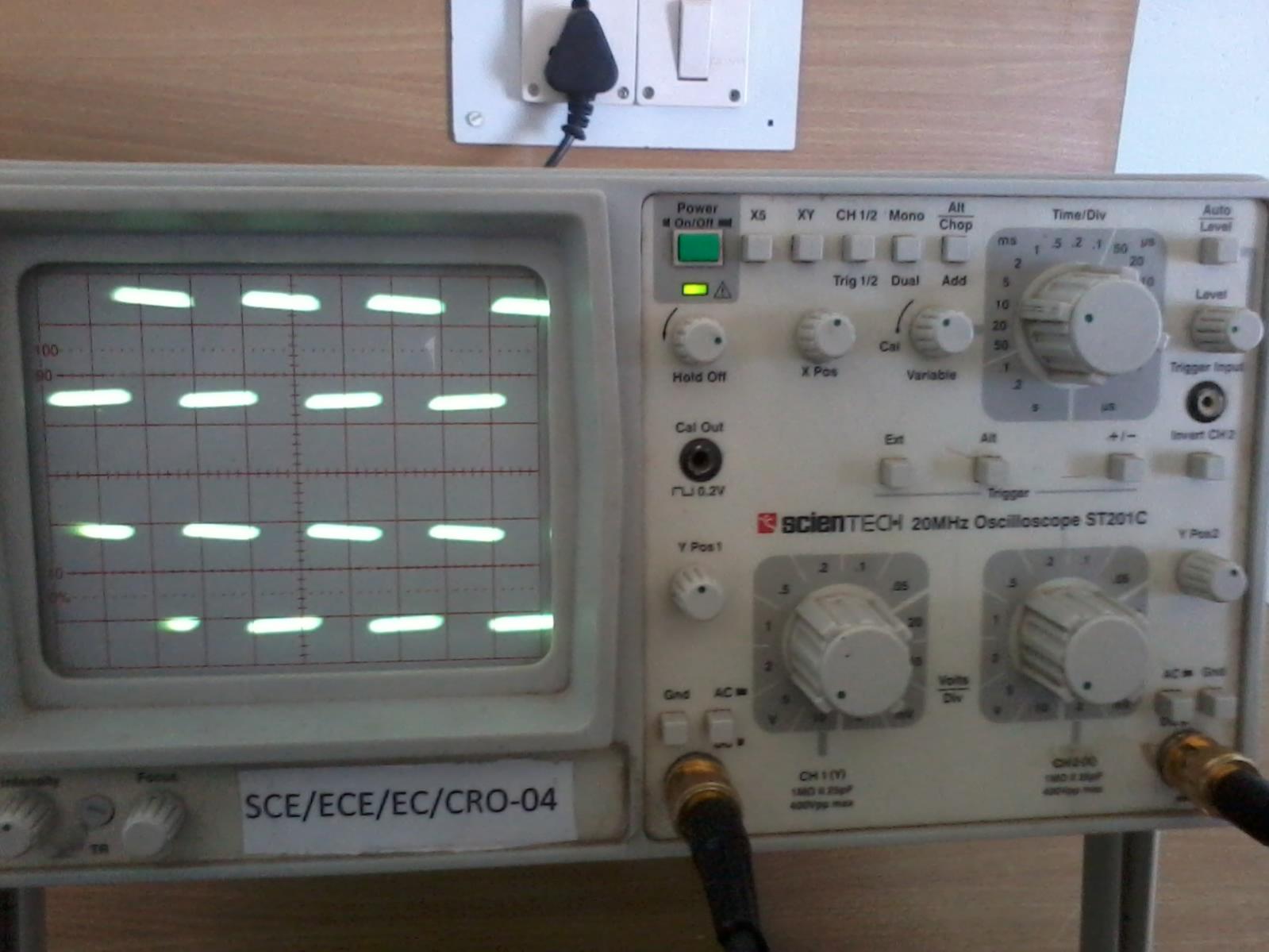

This is the output of Sg3524 in CRO ....
so, can u help me know with uC or any other to have at least modified sine wave..?..??

Hi again,
Oh ok yes that looks typical, thanks for posting that pic.
With a micro controller chip all you have to do is program a delay into the chip for when it is to provide a turn on for one set of transistors, then another delay and output for the other set of transistors (assuming a full H bridge which is typical). To get voltage regulation however you have to provide feedback from the output, which would be filtered one way or another, then used to adjust the output for the correct amplitude. Without voltage regulation you only have to program delays and use two outputs, so maybe you can start with that first and see how it goes. There's a little bit too this kind of project so it isnt a bad idea to start with no regulation and add that later. Alternately you could provide feed forward regulation, where you measure the input voltage and knowing the approximate response of the output to said supply voltage you can adjust the output pulse width to compensate for the drop when the input voltage droops for example. If you intend to run on a 12v battery then the droop might go as low as 11v or so, but you may want to allow inputs of up to 15v to use on a car that is running, so the input range would be about 11 to 15v.

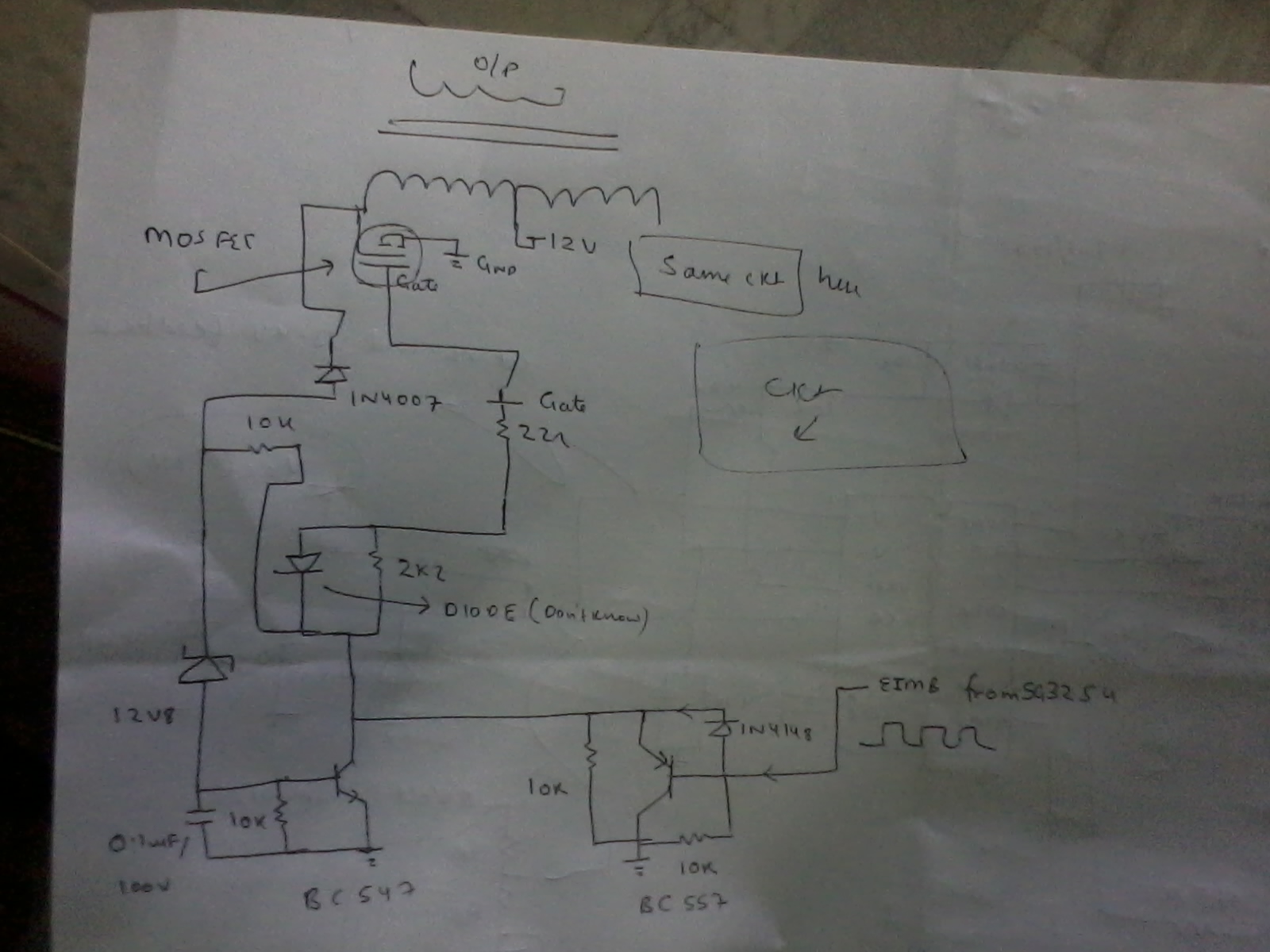

here is the schematic...
1 contain only sg3524 circuit
2. contain the mosfet driver ckt only...
if i want to go with IGBT then changes i have to do??

Hello again,
You have to look up the differences in driving a MOSFET as compared to driving an IGBT.
Opto couplers are sometimes used, but it's best to use them at low current drive to preserve the internal LED which ages. You only need an opto if the output has to be isolated and is already isolated from the mains supply via a dual winding transformer.
OK, if we talk about ferrite core transformer working how we choose them is there any difference in there rating,etc etc?
Well you do have to look up their ratings, max current, max drive voltage, etc. You have to download the data sheets for the parts and decide which is better and cost effective. That's a part of every design really. Of course you should allow some margin of safety so that the parts are not stressed too hard. 150v parts in an 100v application might be good, unless the voltage can go twice as high as the source voltage and then you need a rating greater than 200v for example. If there are any spikes even after snubbing you also have to account for that.
