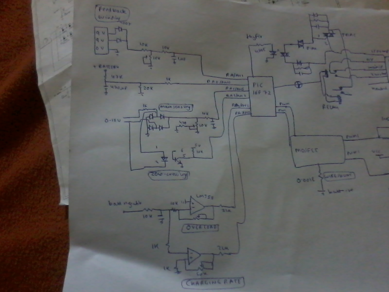

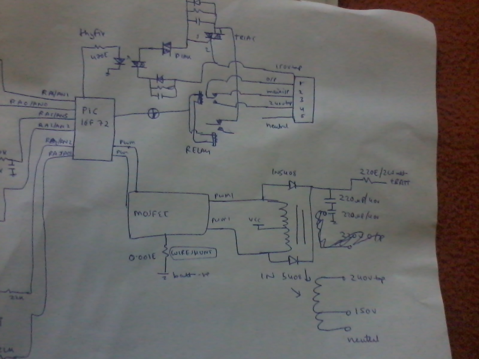

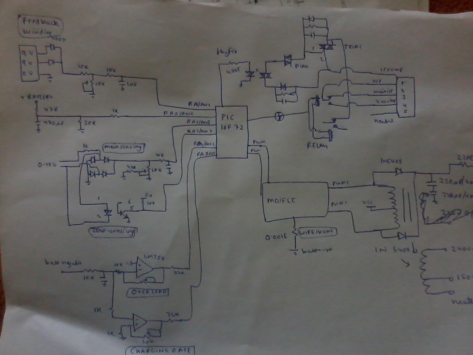

How to generate a Modified sin wave...?
where is the 150 v taping line from the triac on top of the header going?
here it is........

I am gessing some kind of voltage regulatoin.
Where did you get that circuit?
Don't gess i think it is for battery charging when the inverter is in off state....the other transformer is for regulation....
Can anyone explain me the working of it??
from manufacture
I Can't imagine any Manufacture supplying a Poor Quality, HAND DRAWN Circuit like that.
And without knowing the Programming for the "PIC", It isn't a Practical circuit to Determine what it is ment to do or to Duplicate it .
The schematic is redrawn by me only some part not fully sketched....

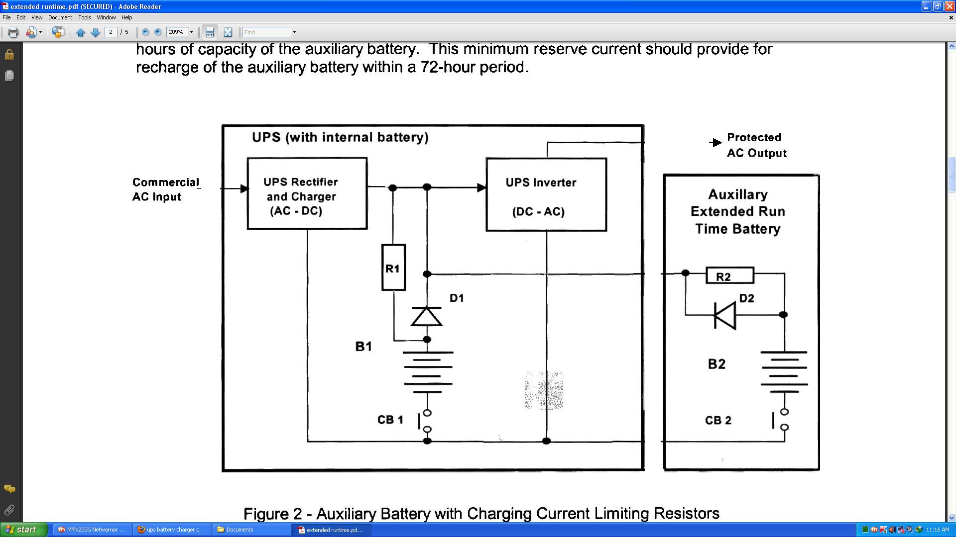

hi
i found this circuit while searching on Google what is the use of diode and Resistance // to it??

In standby the battery is charged via R1. When the battery is supplying current the diode by-passes R1.
The circuit i posted back, as i said i think it is used for dc battery charging but there is no diode rectifiers at center tap so how it is working??
