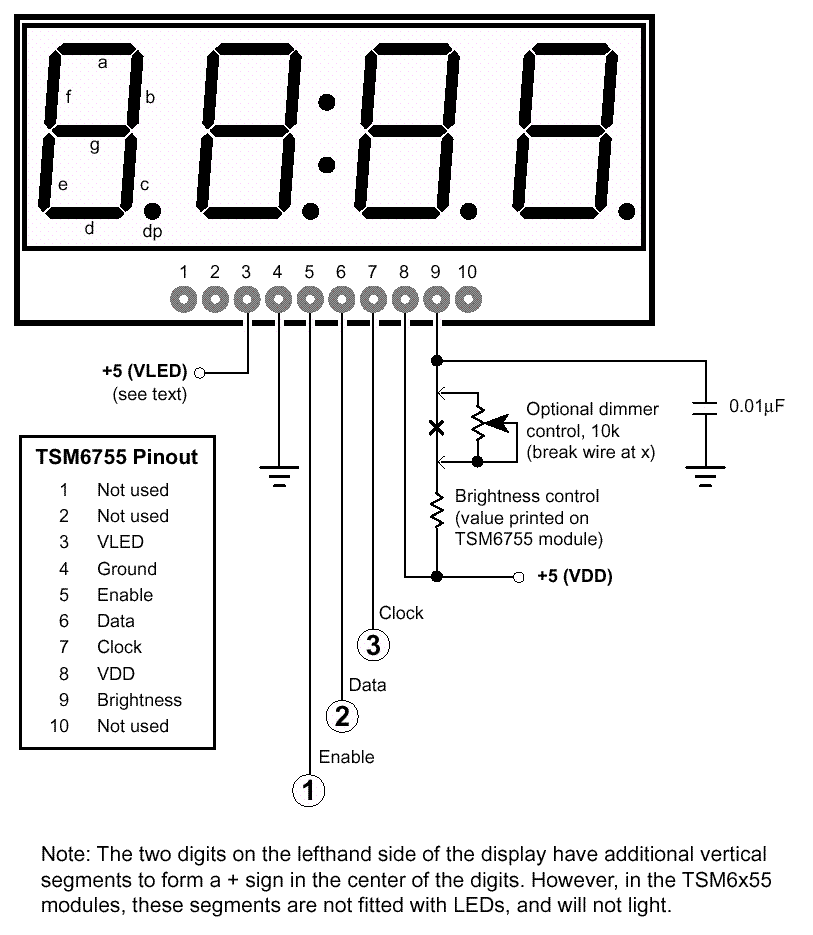

This is the only datasheet on the net for the display. below is a partial one from another source.
Thanks for helping.........Al

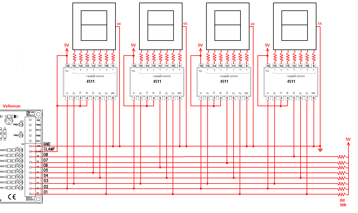

While it is fairly simple to bit-bang the data, it would be pretty slow to load the data into the display. The Velleman USB kit has a latency of 20mS per command. To clock in 36bits would take a minimum of 1.44 seconds because each bit would take 2 commands. With basic glue logic, such as x4 CD4511's and associated LED displays, you could do it in apx 0.16 of a second because only a total of 8 commands would be needed.
So basically, where we go from here depends on how fast you want to be able to update the display.

The reason I chose the 4511 or 74HC4511 was that it has a built in data latch. That way you can put all 4 of the ICs BCD inputs in parallel which would use up only 4 of your 8bits on the digital output port of the Velleman. Each one of the remaining 4 output bits would go a LE (active low Latch Enable) input of a 4511. For example, say that the lower four bits go to the BCD inputs and the upper 4 go to the LE pins of the 4511s. If you wanted to send the number 1234 to your display you would output this hexadecimal sequence on the Vellemans digital output port:
E1
F1
D2
F2
B3
F3
74
F4
I can draw you a diagram if that was too confusing.

Yes, I think I do need a diagram please, I am no expert with electronics. I just muddle through. Most of the time I can follow diagrams and even expand on some, providing I can grasp the basic idea.
OK, here ya go. The data I posted below may have to be inverted depending on how the Velleman outputs a logic high/low, but the basic principle is there. I assume a bit set to 1 turns the output transistor off (Makes the output high) in the example data below:
E1
F1
D2
F2
B3
F3
74
F4
