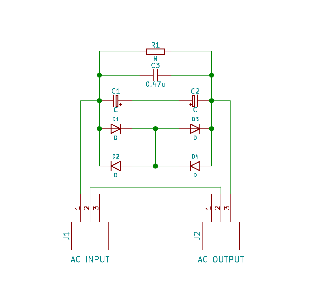

Here is some PCB board on ebay, there is a schematic with it too (image attached). I guess its worth it (the ebay thing), there was a humbuster 3 that did the same thing for USD299 and same ingredients.

It draws 1.7 W or about 3 VA on idle, open outlets

Hi CS,
The circuit does not make sense, to me anyway.
You are not by any chance operating a 120V equipment on 240V are you?
Or perhaps the equipment has a voltage adjustment switch/link that is not set to the appropriate position to suit your mains supply voltage.

If the local mains supply has a net DC component, this can lead to magnetic saturation of the transformer core and high current peaks on the peaks of the supply voltage.
Also consider that the windings can move slightly due to passing a current in a magnetic field, hence low frequency vibration.
Also there is magnetostriction, where the transformer core changes size slightly as the magnetic field changes.
Look here: http://hyperphysics.phy-astr.gsu.edu/hbase/Solids/magstrict.html
Think of all the billions of transformers sitting on the mains, each will short out the DC.
If there is DC it would have to be injected in my house or from house to pole. My house is transformer isolated from the mains.
If there was DC then the core will draw more current (on the + and less on the - of the sign wave{or the reverse}) and thus eat up the DC.
I was thinking in terms of some iffy cheap power supplies or some other thing using half wave rectification and hence distorting one particular half cycle.
If the two half cycles, positive and negative, of the AC waveform are not identical, there will be a net DC component.

for the schematic, thats what other threads say, capacitors and diosed anti parallel. There may be DC bits, with all the inverters, dimmers and switch mode power supplies. I may as well use some in my amps, less trouble

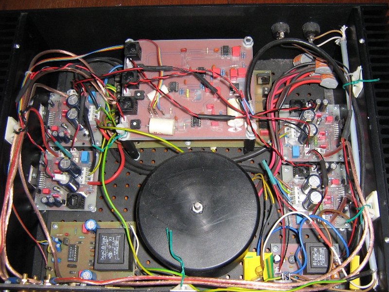

mechanical noise is minimum, if I put thr trafo on the floor, its quiet. Set the trafo on some sheet metal, it starts making a buzzing noise. So I thought as simple test, when the trafo is far enough from the sheet metal, so it stops buzzing, then it would not induce that much into the housing either and subsequently into the housing and the circuits.
When I disconnect thr trafo and frrd the amp via a lab power supply, the speakers have a small pure 50 Hz hum. If I leave the trafo indide the housing and connet to 240V but not to the rectifiers/caps. Feed in from lab supply. Then there is a buzz in the speakers, the kind of sound like a step down transformer nearby. Mostly high frequency. Now I got 2 way speakers connected, it tends to come from the high frequency end. Rectifier is not connected, just to get that one eliminated as source.
I was hoping, eliminating the pysical noise (the housing stops vibrating, since it gets less magnetic field) would also eliminate the noise coming from the speakers.
Crossover is a separate board, disconnected. Has seperate power supply, disconnected.
Its starground.
I cannot see anything on the scope, but its annoying, can hear it from 2m away

the bottom and top plate is steel, rest is alu
transformer has no shield it seems
the noise stops, when I set a jumper to 0V on the amp inlets

the photo is the amplifier. Its TDA7293 monoblocks. And before that analogue crossover. So each of the monoblocks generates the buzz. No headphone socket. Tried with individual drivers and loudspeakers. Its indipendent from the loudspeaker cable length, now its 2m, before it was 6 or so.
Got some 100 Ohm resistors, connected the secondary windings of the transformer. Draws about 1.6W now, its 240 to 22V transformer. Buzz did not get worse than secondary windings open.
