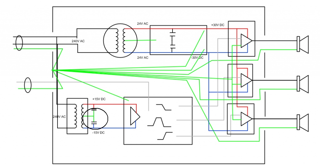

If you look at the schematic of a commercial audio amp, you will often see all sorts of weird components scattered about, mainly capacitors. They are there to cure the many little annoyances that arise.

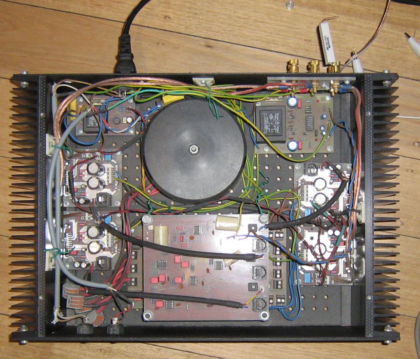

With any audio amplifier, let alone the high power version you have, the layout is super critical as are many of the component types.
Could you post a schematic of your amplifier and also a picture of the physical layout.

top left supply for the relay that switches mute on/off
top right supply for crossover
below transformer 3pass crossover
underneath crossover the power supply

No reservoir capacitors or are they underneath?
I hope you don't mind me saying this, but I suspect layout problems.
The two auxiliary power supply transformers will also be chucking out qute a magnetic field
Like the toroid and the case.:confused:

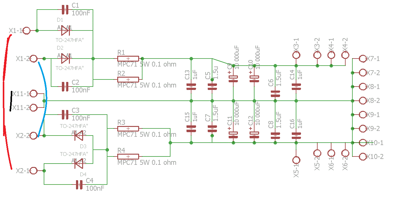

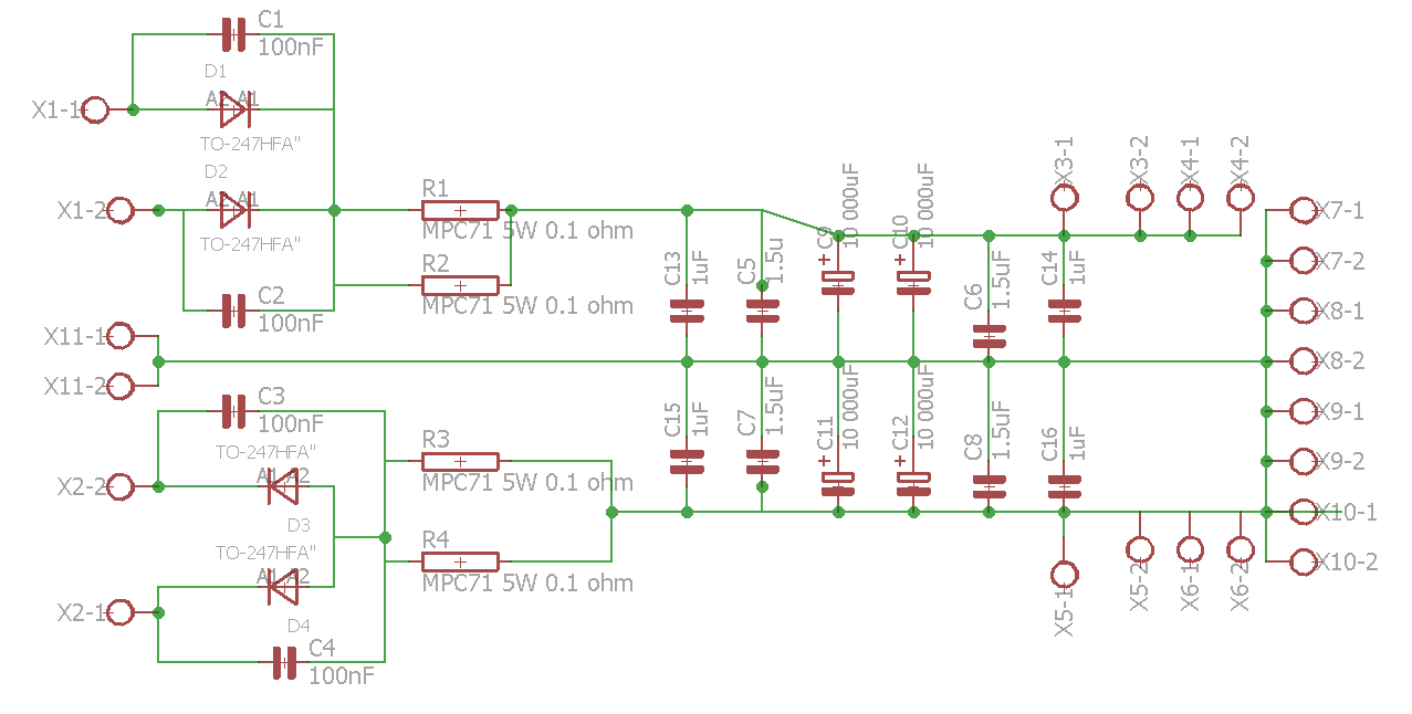

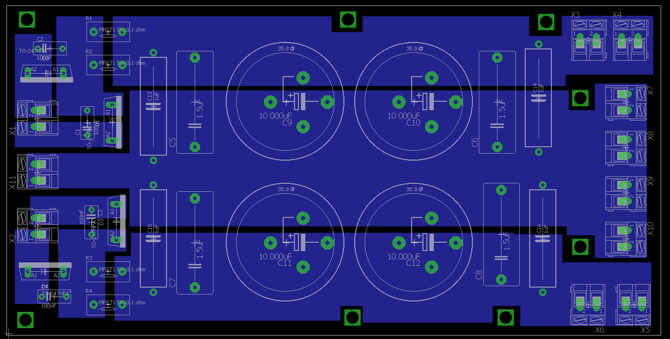

Here power supply. The Cs across the diodes are film, have to replace them with ceramic.
I disconnected the 2 small transformers, does not make a change.

Wow! nice power supply.:cool:
I assume that the torodial transformer has two center-tapped secondary windings, making a total of six wires.
Would you like to try this:

I messed up the supply, transformer has 2 centre and 1 each end, so I had to do some magic. Anyway, that was my next plan. 22:30 in here now, see if I get it done
OK no rush- I have to do some building work pretty soon anyway.
Can you post a schematic showing the transformer primaries and secondaries?

here the secondary conns. Had to wire that op on the fly as the transformer has 4 secondary conns. Will do the wiring tomorrow. Primary goes from power at the back in to a switch on the front panel then back to the transformer, the other to the power in ar the back.

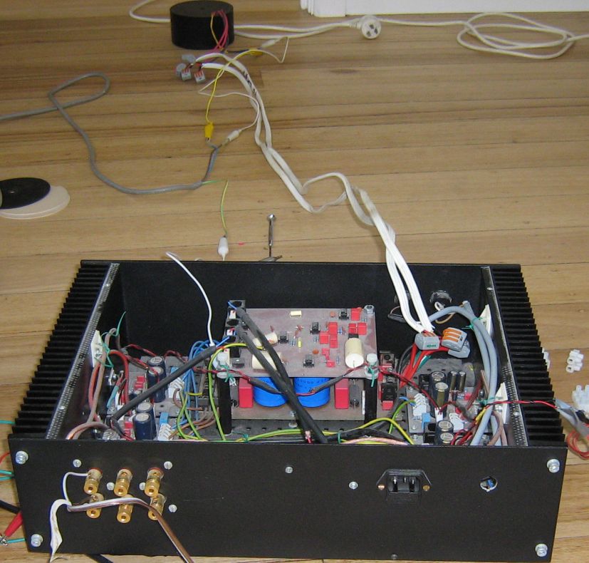

ok, did that, transformer about 1m/3 feet away. any other transformer inside the housing disconnected. Power for mute in/out relais from lab supply.
Hum is still there. But, when I switch the mains transformer off, mute is off (as in speakers running of the power supplys caps while they are discharging) the hum is still there. Something must be oscillating. Now remember, the crossover sits over /on top of the power supply. When I disconnect the cable from the xover to monoblock in, there is small white noise, cable back on, buzz is back. So next step is replace foil caps parallel to rectifier diodes in power supply with ceramics, as that seems to add some riesistance and it acts as a snubber. But still, without transformer, why is it still oscillating? Crossover is not powered.

ok, did that, transformer about 1m/3 feet away. any other transformer inside the housing disconnected. Power for mute in/out relays from lab supply.
Hmm, interesting, but not unusual.:)
Can you confirm this:
Configuration
(1) There is no mains connected to the amplifier whatsoever.
(2) The amplifier is in no magnetic fields: near to cables carrying mains, TV, fan etc
(3) The amplifier is on a non magnetic electrically insulating material.
(4) The mains torodial transformer is outside the amplifier case 1m away and is powered by the mains (230V 50Hz)
Symptoms
(1) With the above configuration the hum can be heard from both left and right speakers
(2) When the mains supply is completely removed from the transformer (live neutral and earth) the hum is still present from both speakers while the reservoir capacitors still have a voltage across them.

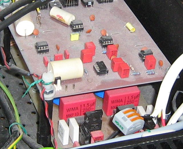

Can you also confirm this. With the configuration above, if you disconnect the two cables connecting the xover to the monoblocks, the hum stops and all you can hear is some background noise. Is that background noise normal and acceptable to you?
So next step is replace foil caps parallel to rectifier diodes in power supply with ceramics, as that seems to add some resistance and it acts as a snubber. But still, without transformer, why is it still oscillating? Crossover is not powered.
With monoblocks in mute, it draws 1.6 or so W, monoblocks on 12W. The transformer does not get louder wirh more load.
diodes are these
thread on bypass resistors on diodes
https://www.diyaudio.com/forums/power-supplies/133916-bypass-capacitors-diodes.html
I hope you do not mind me saying this, but it would be best to avoid considering any solutions at this stage until the root cause of the problem is established.
But just to say that from the symptoms, the fault is unlikely to be connected with the diodes or suppressor capacitors (to suppress diode commutation noise) across the diodes .
It is unwise to use ceramic capacitors in an audio amplifier, except possibly as suppressors across the rectifier diodes, but even so, polypropylene film capacitors would be a better choice. Ceramic capacitors not only generate distortion but their capacitance varies with voltage, temperature, and age. Ceramic capacitors can also act as electrical/sound transducers. These shortcomings are outweighed by positive characteristics for other applications.

PS: I see no expense has been spared on components- those film capacitors must have cost a buck or two.:cool:

I see some ceramic capacitors, which look like decouplers, on the xover board.
Where do the supply rails for the xover come from. Can you supply exact details of the xover power rails?
Where did the xover board come from?
spec
the earth is still connected to the chassis as I am a bit scared to have it completely floating, voltage wise. Edid: earth (green yellow) disconnected, it becomes quieter.
the xover I did, ther ceramic caps are 100nF in the rails for the +-15 V to the opamps. The xover is not connected to anything, except that cable to the input ot the mono block. This amp is just 1 channel, no need to worry about other speakers.
There is a power cable in the wall about 600mm away, goes vertical. And the only thing it does is power my experiment, so not much magnetic field there.
its all MKPs and metal resistors, opamps are OPA134, then a bunch of Mundort tin caps.
Ok remover all the clutter around and listen to it again. But the buzz kept going with the lab supply for the mute relays unplugged, until its caps dischaged and the relais tripped.
The only thing that goes in is 2x22V DC from the transformer and 3V DC, the minimum to switch the mute relais on. The relais are galvanically separated from the monoblocks. Thats the last thing I can get rid off, feed 3V in from batteries.
