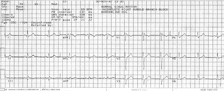

I was designing a portable EKG system. normally there got 3 electrod (ground, +ve, -ve) to measure voltage (in microvolt range) from a patient. Since it is portable, it doesn't have any Ground lead, so the reading is very susceptible to outside interference / noise.
I suppose that a filter system can be used to filter out the noise.
I expect that the signal does not have a discrete frequency, so the better approach is to prevent the interference rather than try to filter it out. Shielding and common mode rejection should be all that is needed.

Yes, I believe such devices commonly use fixed low-pass filtering, the signals you are looking for are all very low in frequency so you can reject any above your highest frequency. But you want to start with the best possible signal you can - don't start with a rubbish signal and then try and improve it, make it as good as you can in the first place.

I enclosed a picture taken from **broken link removed**
It stated it was 100Hz, .... was it high enough to be considered 'high frequency'? was it high enough to implement various advance technology to get a better waveform?

Shielded cables are very important for a good EKG reading. Shielded cables have a metal foil wrapped around their internal conductors. The metal foil is connected to ground and "shields" the internal wires from noise. Just cut open a standard TV coaxial cable to see the foil and internal conductor. The standard BNC cables in your electronics lab should be fine. The sheild works as a faraday cage preventing electromagnetic intrferance from reaching the wires carrying the signal. For extra sheilding use aluminum foil connected to ground to wrap problem areas (careful not to short anything out). Nigel is right about noise - reducing it with properly sheilded cables and electronics is much better than filtering.
It states 25mm/Sec - which presumably is the horizontal axis, so the signals are no where near 100Hz. I presume the 100Hz probably refers to the low pass filter used?.
