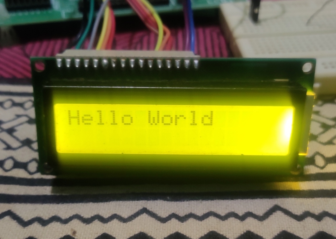

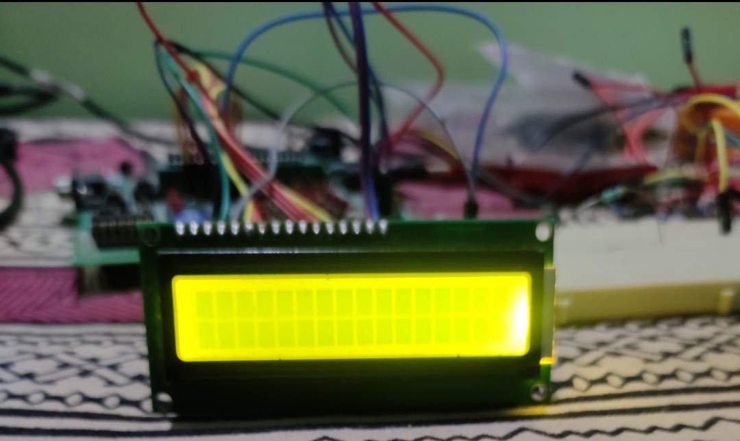

I have done few changes but still not getting data on screen

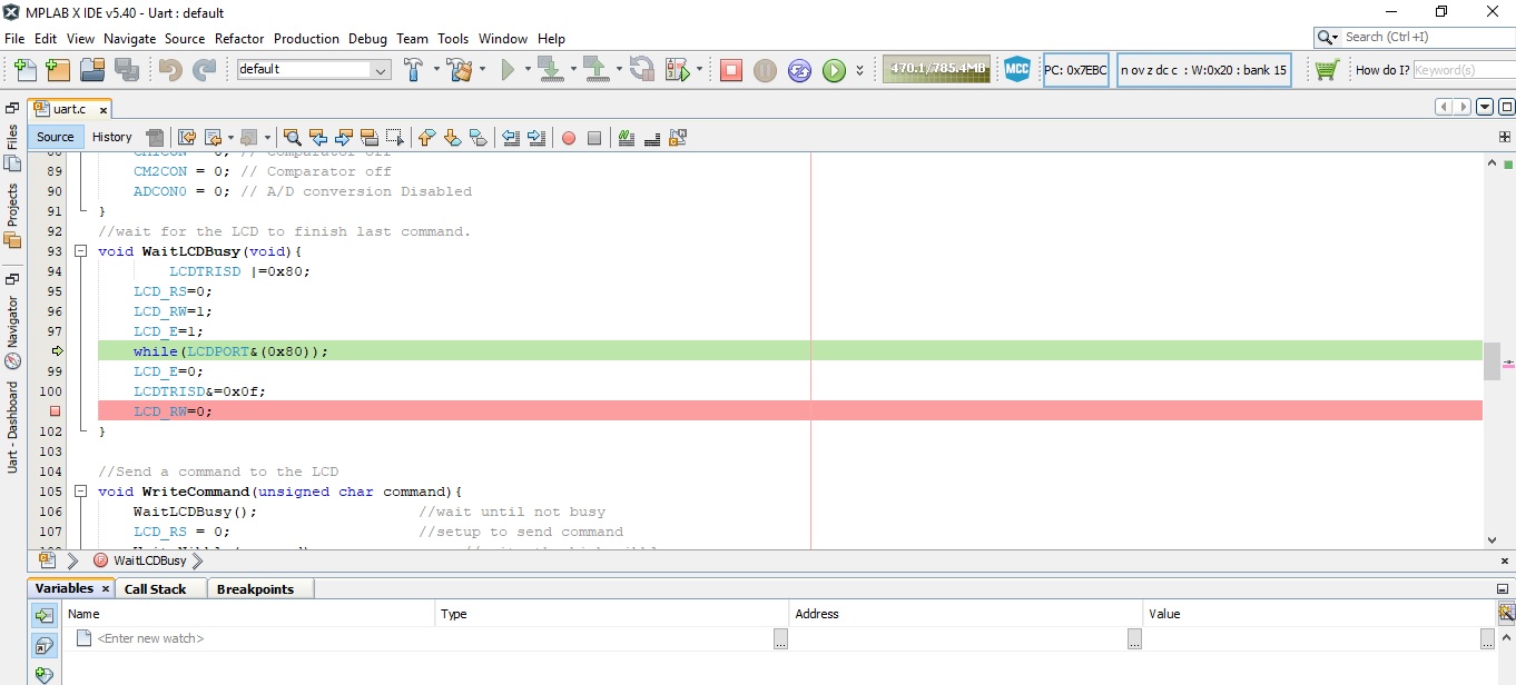

//wait for the LCD to finish last command.
void WaitLCDBusy(void){
        LCDTRIS |=0x80;
    LCD_RS=0;
    LCD_RW=1;
    LCD_E=1;
    while(LCDPORT&(0x80));
    LCD_E=0;
    LCDTRIS&=0x0f;
    LCD_RW=0;

Try initializing your pins before the LCD, thay may be set to analogue. If it still doesn't work then where does it get to?
I have done that still data doesn't display on the screen. but one change I have seen that LCD doesn't show any black boxes
And, where does it stop?
Screenshot
I think the LCD has been initialized but the data routine has some fault that needs to be corrected

Then your hardware is wrong. Did we find out where in the code it stops?
If it's now working then I suspect your R/W line has a problem. But, congratulations, hope the rest of your project can now proceed.
