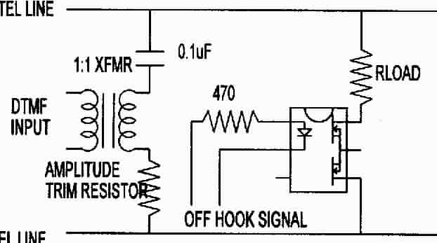

You have to put a DC load on the line to get it "off hook". You will have to determine what that is, I don't remember. This schematic should do the job.

schematic doesn't work for me!
Hi russlk
I couldn't get proper output when i implemented the schematic. Whats wrong..? I think the phone line loads the dtmf dialer - is that possible ? or am i wrong. Any other suggestions for the circuit?

hi russlk,
I used 330 ohm resistor to bring the line off hook.I think this is enough.I also checked this by dialing to our telephone number.I unable to know where is problem.

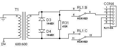

Heres one i used for the UK. It worked fine.
The "IN" is where you put your signal (audio). I used a TBA820M el-cheepo audio amp just before this input with a 1uF coupling capacitor in series with the signal to block DC hitting the coil.
You need a signal of about 700mV pk-pk maximum.
The Coil is a 600:600R line transformer.
The circuit is NOT approved for use in the UK.

That one's too complicated...! But thanx anyway.
Thank you Sebi for the diagram. :p :D
But my problem is that i'm using an RPS (5 volt) for Vcc supply to other components and ICs of my circuit and i have to use the same reference point for measuring voltages at any node of the circuit. :shock: But i cannot ( i suppose and i'm told not to ) connect any of the two conductors of the Tel. Line to the reference terminal of the RPS. :cry: So my output is not properly referenced..!
The circuit given by the above link uses the voltage in the TEL line in some form to power up the IC 91214 (i.e. does not use an external power supply). This might again create a new problem wherein different stages in the circuit being referenced to different voltages..! (i'm not sure)
One more problem is with the R-Load. I tried to use larger resistances as Russlk had suggested (like 1K or 2.2 K) but they get really heated up...as the off-hook voltage doesn't come down very much.. It stays up there at 32 volt ( on hook voltage 38 volt approx ). So i'm back to using 330 ohm resistor as S'raj has done.
So please help me in this regard also .. :roll:
Thanx a lot for showing so much interest.
R.Vinoth
What is the general range of amplitude trim resistor?
Amplitude trim resistor
The range of amplitude trim resistor i used is 2 to 10 Kohms. I found it didn't affect my output much..!! :? Wonder what for it is connected.. :?: :?: i'm ignorant..if anybody knows pls reply.. :)
