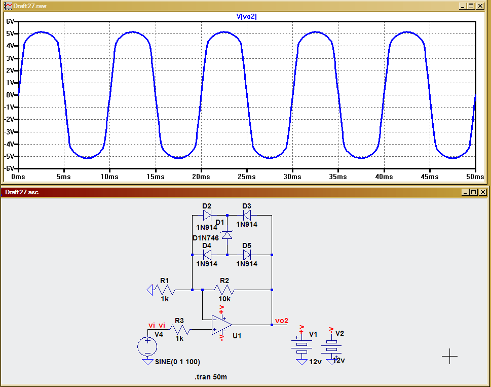

Have you considered using say, two 4.7V zener diodes in opposing series across the OPA's feedback resistor.??

Something like this, add the 1N914 diodes.

Since the Zeners have small forward voltage drops you could just use Two Zeners (no need for the 1N914) in series with each other and in opposite polarity.
The Postive limit would be: Vz1+ Vd2
Negative limit: Vd1+Vz2
If I used 4.7V zeners and they had Vd of about 1V then I would get a limit of 4.7+1 = +/-5.7V
If you recheck the circuit I posted you will see that I used 4.3V zeners and 1N914 have a forward voltage drop about 0.7v

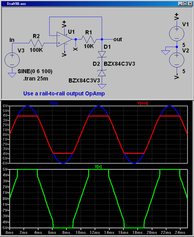

Here is a similar circuit which produces a "squared" output. Note what happens at node X.

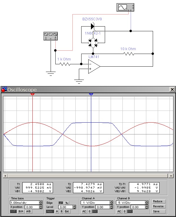

If you want a near symmetric plus and minus clip, the use one zener diode in the center of a diode bridge circuit. That avoids the tolerance voltage difference between two zeners of the same nominal voltage. But with that you now have two forward diode drops added to the zener voltage.
The bridge circuit can be use in the feedback circuit as danjel showed, or clamping the output as Mike ML showed.
like this? and so the clamp voltage is Vz + 2* Vd ?

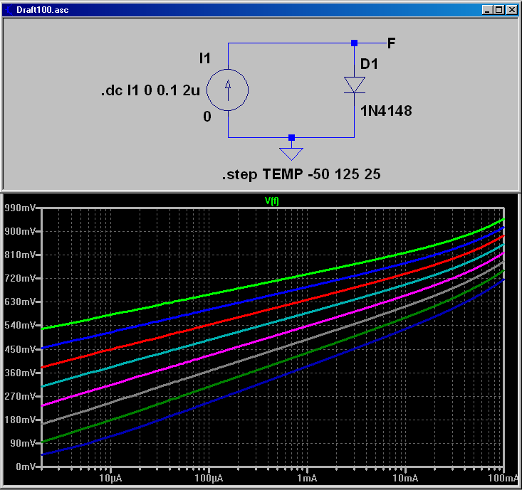

This also explains why the clamp voltage seemed to be higher than what I calculated since the combine forward voltage drop should be 0.6+0.6+3.3 = 4.5V but his simulation is showing a clamping above 5v
Your assumption that the forward drop of a Si diode is 0.6V is far too simplistic.
care to elaborate? Obviously it is an approximation and I guess in reality it is closer to 0.7V. What calculations should I be doing then?
Thanks that is very illustrative!!

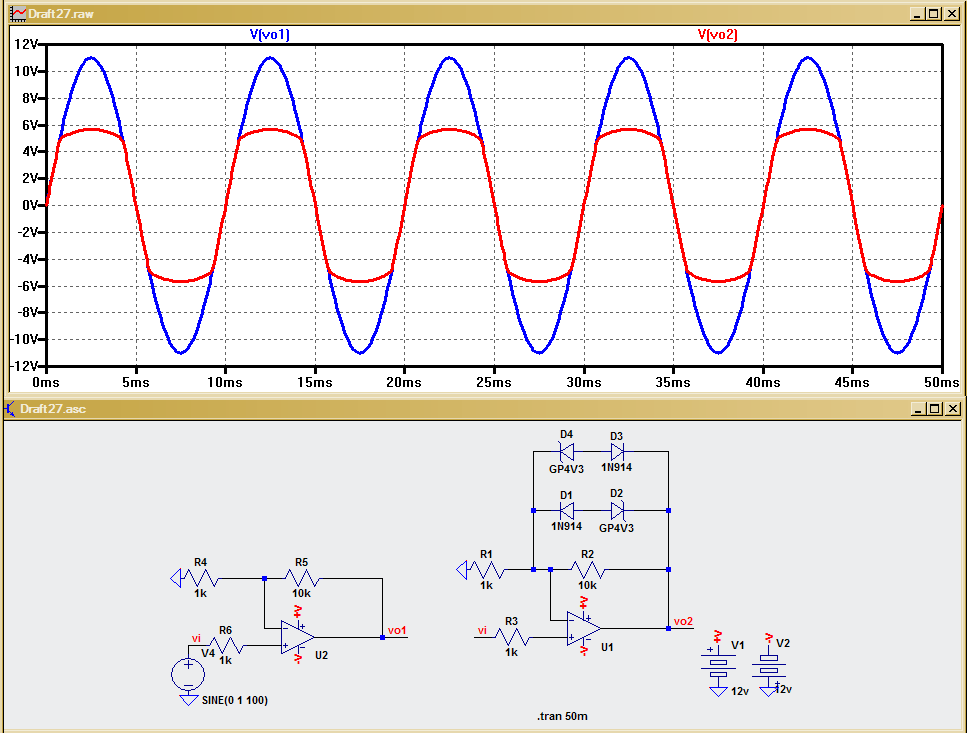

Here's my simulation with a 3.9V zener and a 10kΩ feedback resistor for an un-clamped gain of 10, which gives a clamp voltage near 5V. The actual clamp voltage will vary slightly with the input and feedback resistor, since that varies the clamp current and thus the voltage drop across the diodes.

Eric, your version is non-inverting, which means that the gain is still 1 when the clamp is operating. That gives the rounded waveform clamp levels shown in the simulation.
An inverting version should give sharper clamp levels.

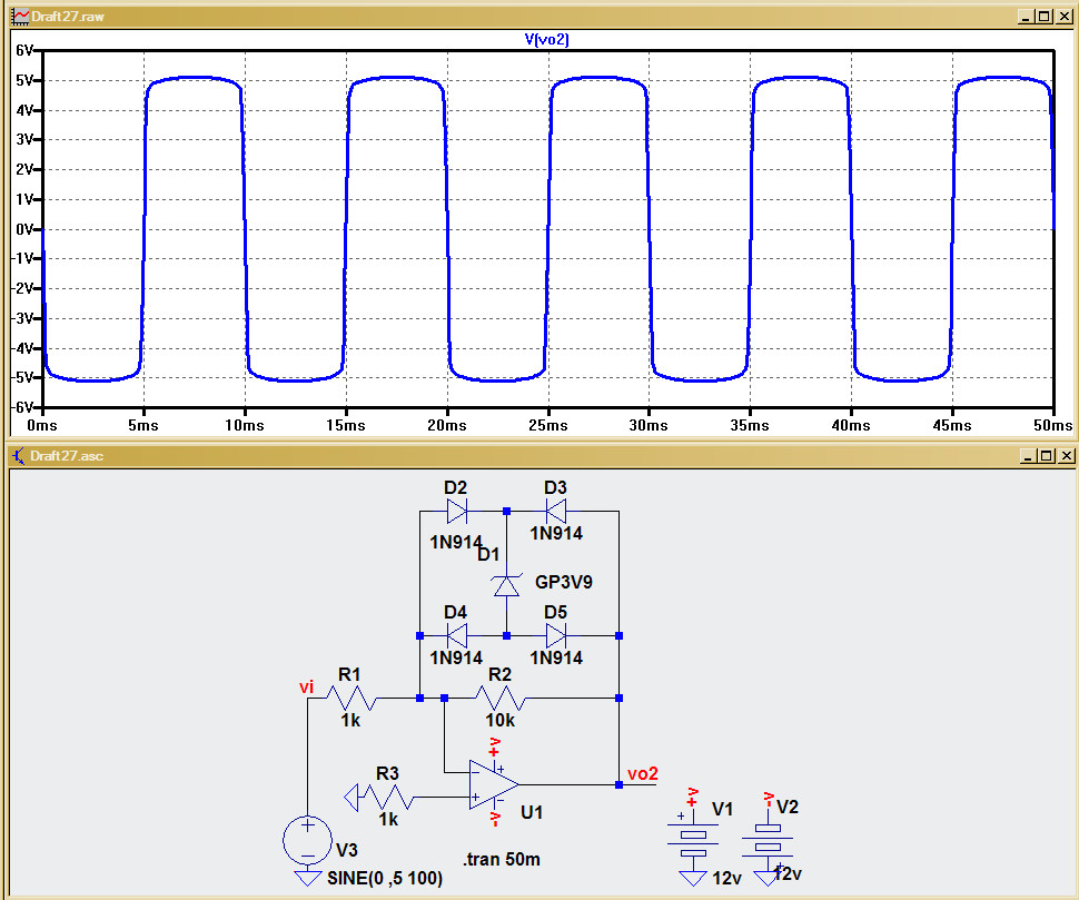

As suggested, inverting OPA Gain *10.
