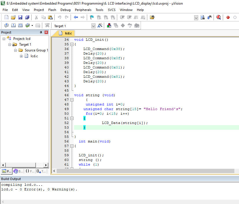

What's wrong do you see in program?
I can only assume the program compile is failing and you are using an old hex file... The messages from the compile should have an error.. The function String cannot have the same name as the variable String..
Show me the compiler error messages..
I compiled program with error

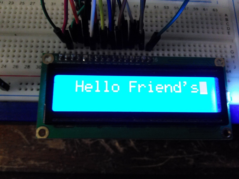

what I didn't mention ? Have you read post #12 and #14. there is all information
I want write program for LCD on a 8051. I want to see the string "hello friend " on my LCD screen
this is program

#include<reg51.h>
#define port P1           /* Data pins connected to port P1 */
sbit RS = P2^0;           /* RS pin connected to pin 0 of port P2 */
sbit RW = P2^1;           /* RW pin connected to pin 1 of port P2 */
sbit EN = P2^2;           /* EN pin connected to pin 2 of port P2 */
   void Delay(unsigned int wait)
           unsigned i,j ;
           for(i=0;i<wait;i++)
           for(j=0;j<1200;j++);
/* Function to send command instruction to LCD */
void LCD_Command(unsigned char cmd)
    port = cmd;
    RS=0;
    RW=0;
    EN=1;
    Delay(2);
    EN=0;
/*Function to send display dato LCD */
void LCD_Data(unsigned char Data)
    port = Data;
    RS=1;
    RW=0;
    EN=1;
    Delay(2);
    EN=0;
/* function for delay */
/* Function to prepare the LCD */
void LCD_init()
    LCD_Command(0x38);
    Delay(20);
    LCD_Command(0x0f);
    Delay(20);
    LCD_Command(0x01);
    Delay(20);
    LCD_Command(0x81);
    Delay(20);
void string (void)
     unsigned int i=0;
    unsigned char string[15]= "Hello Friend's";
     for(i=0; i<15; i++)
            LCD_Data(string[i]);
   int main(void)
  LCD_init();
   string ();
   while (1)

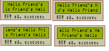

message should be print on first row and it should be fixed
I've read the entire several times thread. You need to tell us EXACTLY what you want and exactly what you're getting when it's not what you want. More than once, you've provided code that you said didn't have the correct output but never told us what the code output was. That's not helpful.
Also remember that we don't have the code or LCD in front of us. We know NOTHING about the LCD. We don't know what commands are available or what those hex commands you are sending with LCD_Cmd() are supposed to do.
Also, giving just one input and output is not enough. We need more of them to figure out what the code and LCD are actually doing. We need multiple test cases.
Most of the time in this thread all you do is go "This is what I have. It's not working. What's wrong with it?" Then we provide a suggestion and all you do is come back and say "It doesn't work." You don't even tell us what it did most of the time. It feels like you're just sitting there waiting for us to reply without thinking or trying anything on your own You need to spend that time making little changes to your code and investigating what it does to try and give us new information to boil down the behaviour of the problem.
For example, look at the image of the LCD screen you provided. Did you even think about it very much?
Hello Friend's
lo Friend's Hell
What happened to the missing "Hel" at the beginning of the second line? I don't know because I don't have enough information. You provided a single image of what you said was moving text. Some text could be going off the edge of the display and getting cut off before moving to a new line or something else. I have no idea. If it's moving text, show more than one image or else it's like trying to understand a video from a single frame. Also, don't use "Hello World" or "Hello Friends". It's not a good test string. Use strings of non-repeating, easily countable characters "1234567890abcdefghik". Try strings that are short enough that they can be repeated on the screen as well as strings that are long enough that will run off the edge of the screen or wraparound to a newline. That will make it easy to identify different things like how many characters are being displayed, when they are repeating or moving to a new line, and which character positions always go missing.
Start like this: Feed many inputs that will provide unique results that will tell you about different things in the system and see how the system reacts. In this case, feed short strings and a very long strings into the LCD and see what happens. The string needs to be non-repeating characters so you won't get confused if something appears twice. Like "123" and "123\n". Then feed long strings that will have to run off the edge of the screen or wrap around like "1234567890abcdefghijk", and "1234567890abcdefghijk\n".
Does the short string move or repeat? How does it move or repeat? How does the \n change things?
Does the long version repeat? Does it run off the edge of the screen or move onto a new line? Or does it do both where it runs off the edge of the screen for a bit and then move onto a new line so characters in the middle are missing?
Do things like this to hunt down exactly how the LCD and code are behaving. It's not enough to just show us one input and one output and expect us to be very helpful. You have to do some investigative work to try and boil down what the program and LCD are actually doing.

But good right there. What I guessed from your one image seems to be confirmed from your multiple images on the LCD. You can see in the LCD images that characters are running off the screen. The LCD screen is able to accept characters that do not display. Add \n to the end of your string and see if it displays two complete lines properly. Fix one problem at a time.

Do you have a manual for your LCD commands? It looks like your LCD automatically does a newline after it has received enough characters, but this number of characters is more than what the LCD can display on one line, so all those extra characters get cut off at the edge of the screen. It might be adjustable with a command. If it's not, then you'll just have to manage it manually in your code.
I bet there's something important about your LCD commands that you're not aware of.
so why was it moving and repeating? you were only sending the string once right? what did cursor off do?

I tried your code changed the port stuff so it match a pic here what you get cool .
Parth could you post the working code plz I'd like to see it Thanks
I lost my that code while practicing. I wrote new code
