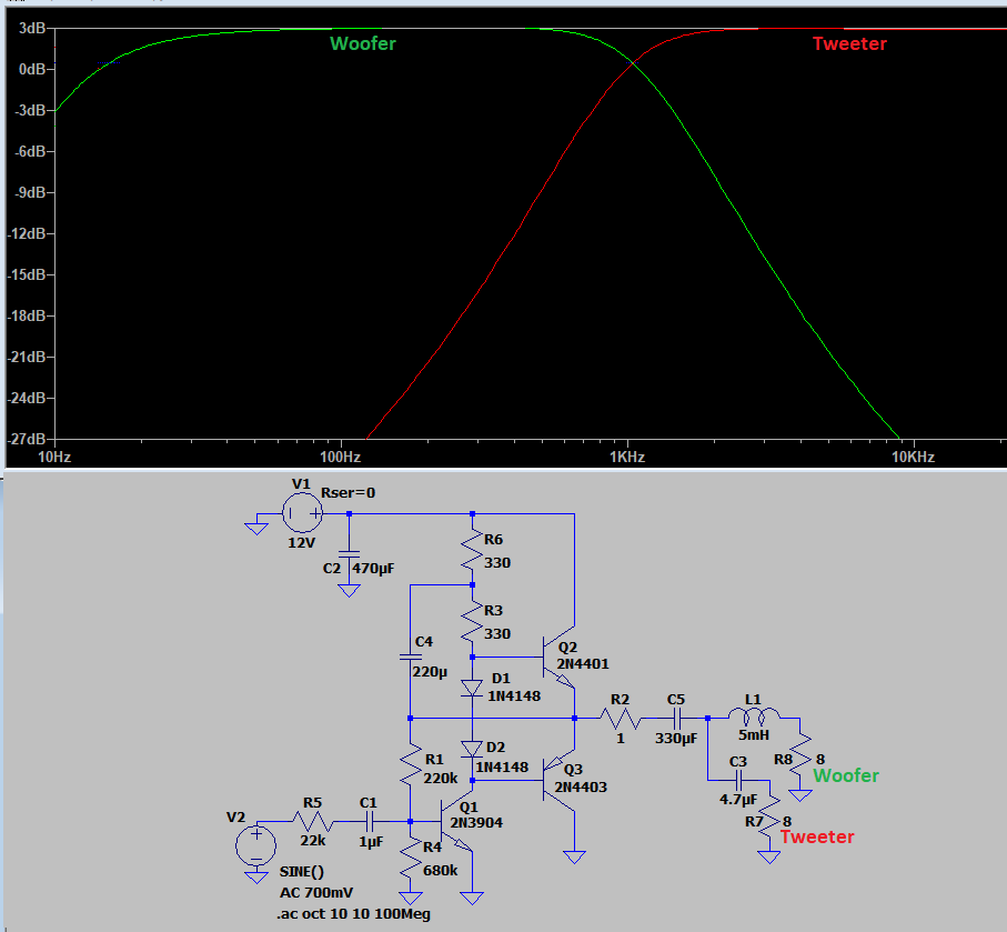

I simulated an amplifier with a fixed output 4 ohms resistor so that total speaker power can be seen.
I added a simple crossover network and it divided a woofer and tweeter to -3dB at 1kHz.
I feed equal levels of 150Hz and 5kHz.

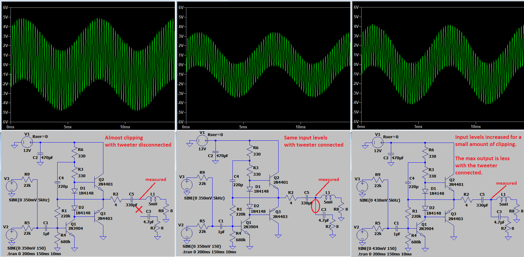

With only the woofer and its inductor connected to the fixed output resistance of the amplifier I turned up the input level almost to clipping. (4.9V peak).
Then I connected the tweeter and its capacitor to show the output level dropping because the woofer and tweeter are basically in parallel and drawing more power, causing more voltage drop in the fixed 4 ohms output of the amplifier.
Then I turned up the input levels of both frequencies almost to clipping (4.2V peak) which is less than the 4.9V when the tweeter was disconnected.
Therefore the load is less than 8 ohms when the woofer and tweeter are both playing.

As you are using complex waveforms rather than a single sine wave, voltages are not a good measure of power. Measure the RMS current through the series resistor on the output.
