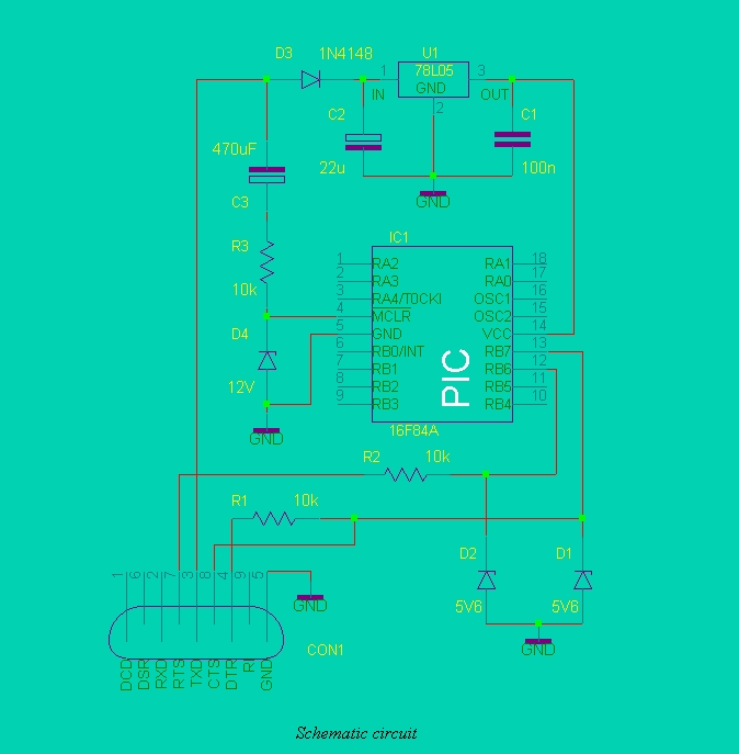

How to program PIC16F876 with this programmer below
I need circuit wiring,whic pins from pic876 to pins of programmer.Can somebody help me?

I've based the following on the Pic in your schematic being a 16F628.
16F628 16F876
pin 4 MCLR pin 1
pin 5 Vss pin 8 and 19
pin 14 Vdd pin 20
pin 12 PGC pin 27
pin 13 PGD pin 28
