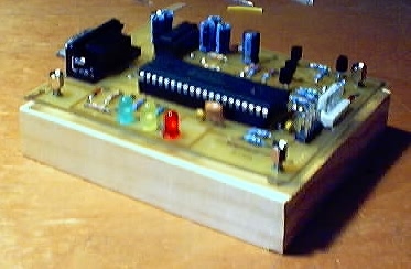

Along the same line.
You can also go the old school route and mount the board to a small block of wood on standoffs. It give the board a bit weight too.
Yes physically attaching a substrate seems to work just as good.
