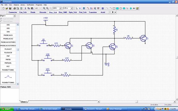

Maybe this can help
Use proper power rating components. And keep in mind that no failsafe is in this design. no need to convert the 15V again to 5.
Please verify with more experienced designers
see attached file

I'm Confused
I'm not just sure what that circuit is supposed to do...or how.
the base of the 3 transistors in line will take the input from your sensors in the tank and then send a signal to the driver transistor to the right. keep in mind that the transistor on the right is pnp and all the others are npn. any one of the 3 transistors when foward biased by your transducer in the tank will send a negative bais to the pnp( far right) . and inturn output approx 14.4 volts on the collector( this is depending on the load).
so you have 3 inputs which will turn the driver on even if one input is high or 2 input is high or 3 input is high. this means that the you have to setup the swithes in the tank to turn on when the water is low. i hope this helped

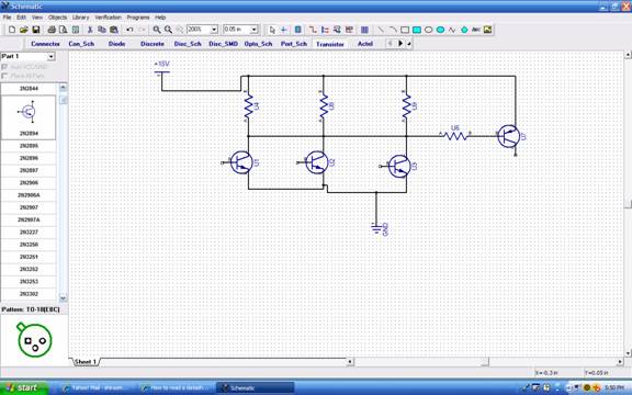

See image for explanation
What type of pump are you using?
Remember that water and electricity are lethal combination

The schematic has 3 collector resistors in parallel. Only 1 is needed.
The input transistors will blow up when a switch is turned on becase the bases don't have series current-limiting resistors.
I tried to remove the millions of dots but couldn't because the schematic is a very fuzzy JPG file type.
Schematics should be saved and posted as a very clear GIF or PNG file type.

Well, I wasn't one of the originators of the practical application but, I see a couple of things. You've essentially invented the 3-input NOR function in your logic.
Water and electricity aren't really lethal at these voltages but, you could get some nasty corrosion over a few weeks.
There is a problem with your circuit. If you close any of the switches you'll short the BE junction (a forward biased diode), of the associated transistor, between your supply voltage and ground with no current limiting device. That'll smoke the poor transistor.

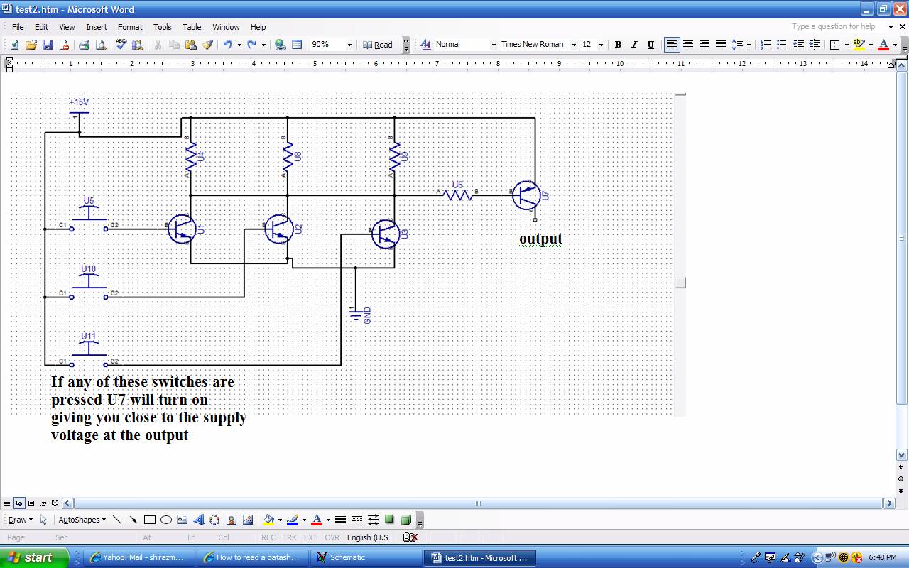

How about this one
Please seek other advice before building the circuit . as you may realize I’m not as experienced as others on the site.

Thanks a lot shirazmacuff for the nice explanation.
I am looking into this currently and try to tweak it a little. Just a confusion. In your circuit diagram where are you connection the positve end of your battery ? In all the circuits I have read on the internet, while using npn transistor we connect the positive of the battery to the base. But you have connected -ve. Will it actualy work ? I will try when I go home.....
Also is it possible for you to post the exact values of resistors and the transistor which you are using. I am only askign so that I can verify it against my calculations. Or let me know which transistor to use and I will try calculating the values of resistors and get it verified with you.

The base of a transistor needs a series current-limiting resistor if it is a common-emitter type like in this circuit. NEVER directly connected to the positive supply voltage.
If the voltage and current are low then any little NPN transistor can be used. The resistor values depend on the amount of current required by the load.
there are 4 transistors
the rightmost one is the output and it is a pnp
the others are npn
I’m pretty confident that the polarities are correct. But for your piece of mind I’ll run a simulation
i will run a simulation as soon as i can.
For typical logic applications your base resistors can be from about 10k to 50k and the collector resistors about 1k to 5k. As noted in an earlier post, just about any NPN and PNP transistors can be used.
I would make one comment on the schematic. You should not directly cross a line (as with your collector resistor) without a connection dot as it appears to be a 'no connection'. Better than the dot is to stagger the connections as you've done in the rest of the diagram.
