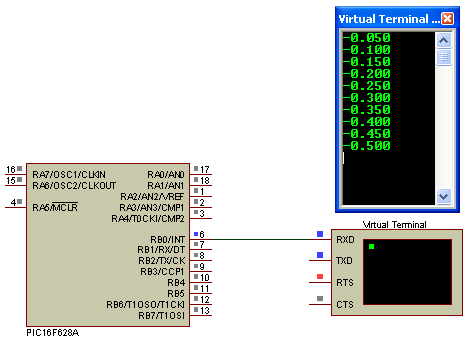

From what I gathered, perhaps this is what your looking for?
Written with **broken link removed**
eeprom-png.13064
Device = 16F628A
Dim Variable1 As Float
Dim Variable2 As Float
Low PORTB.0
While 1 = 1
    Variable1 = Variable1 - 0.050
    EWrite 0, [Variable1]
    Variable2 = ERead 0
    RSOut Dec Variable2, 13
    DelayMS 1000
Wend
Keep in mind that each float will require 4 bytes of memory, and they are not the best solution by any means for most applications

Thanks a lot Gramo, but still need your help if possible.
