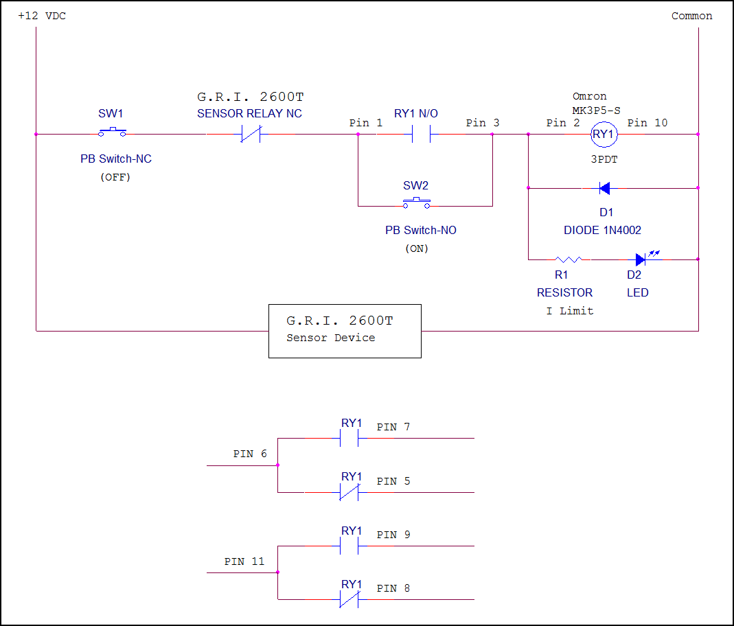

Here's how industrial equipment is started and stopped using momentary pushbuttons. The circuit is called a "locked-out relay":
Notice that this uses an ordinary relay, not a latching relay. You don't want a latching relay in this application.
The idea is that it's extremely easy to de-energize this circuit: just hit the "STOP" button, which is normally-closed, which removes power from the relay coil, bringing the whole show to a screeching halt. If there's a power failure, you don't want the machine returning to the last state it was in, which may have been powered on.
I'm not saying this is the circuit to use. You could use it, however, by replacing the "off" switch with a solid-state relay connected to your water detector through an inverter (depending on the logic level output by the detector).
Anyhow, just an idea.

That's why you don't use a latching relay. Why would you think you'd want to use one? You want it to forget its last state, not remember it.
This circuit will keep the circuit open if either 1) the user trips it off with the NC pushbutton or 2) the power goes out. In either case, it will always revert to being off. It's what's called "fail-safe".

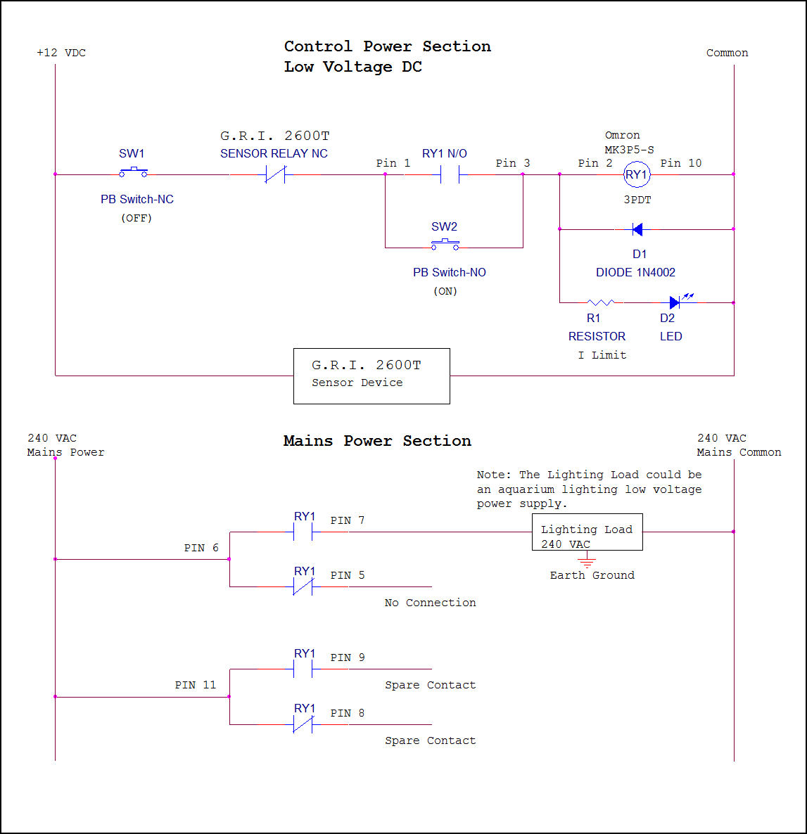

The attached drawing is about what you want. For your sensor you mention "the GRI2600T water detector to detect if the existence of water". According to this data sheet that particular sensor is NC (Normally Closed) and opens with water sense. Also, though you mention 5 Volts that unit is 12 volts.
2600 Operating Voltage 12 Volts DC
2605 Operating Voltage 5 Volts DC
2624 Operating Voltage 24 Volts DC
Operating Current 12 mA
I used 12 volts in the attached because you mentioned the 2600. Now let's look at the circuit:
SW1 is a normally closed push button switch, current normally flows through SW1. SW1 is followed by the normally closed switch contacts of your sensor. SW2 is a normally open push button switch. Pressing SW2 will cause RY1 to "Latch" through the action of RY1 pins 1 and 3 which are normally open and will close when SW2 is pressed. That action causes a self latching of RY1. When SW2 is released RY1 will remain latched.
RY1 is a 3 pole double throw 12 volt coil relay. The purpose of D1 the 1N4002 diode across the relay coil is to "snub" the inductive kick of the RY1 coil whenever it de energizes. RY1 has additional unused contacts which would be used for your load, be it a lamp or whatever. The LED is simply an indicator to show when RY1 is energized and is not required.
If the moisture sensor detects water the normally closed contacts of the sensor will open. When that happens RY1 will open and the load will lose power. Power can also be removed by pressing SW1. If either the sensor opens or SW1 is pressed RY1 will drop out and become un latched.
Look at the circuit carefully and try to understand how it works. This circuit is a very, very common circuit used everyday in general electrical applications. You will note the circuit is based on the circuit Carbonzit initially posted. Remember as to the term "Latching" that RY1 is latched through it's own contacts. If SW1 or your sensor opens then RY1 will drop out. Once RY1 drops out it will remain un latched until SW2 is pressed causing it to latch.
While your initial choice of a relay could be used it would require additionally circuitry which is something you do not want in safety circuits. You want the circuit to be simple and reliable.
If you want the circuit to work on 5 volts just find a 5 volt coil relay. The 12 volts and the relay I show are just a matter of example. Make sure the relay contacts for the relay you choose can handle the load current (lamp or whatever) for your load.
Hope that helps.
Ron

Both of the circuits myself and carbonzit posted are essentially the same circuits with yes, the same end results. They are ON or OFF circuits using a relay that latches itself through its own contacts and provides power to a load. Both circuits use momentary push buttons ( NO and NC) to turn the circuit on or off.
The circuit I posted has a few differences. I used low DC voltage for control of the relay and other contacts on the relay for supplying the load. Attached is my last drawing with a few additions showing the use of the additional contacts. Since the OFF push button is normally closed I did add in series the normally closed switch contacts of your sensor. This configuration allows the circuit to be turned on and off as long as no fault exist. When a fault exist and the sensor contacts are open the relay will not energize and latch itself. I used low voltage DC control as when I have to design a circuit like this I prefer low voltage control and in many applications rules dictate that I use low voltage DC control.
