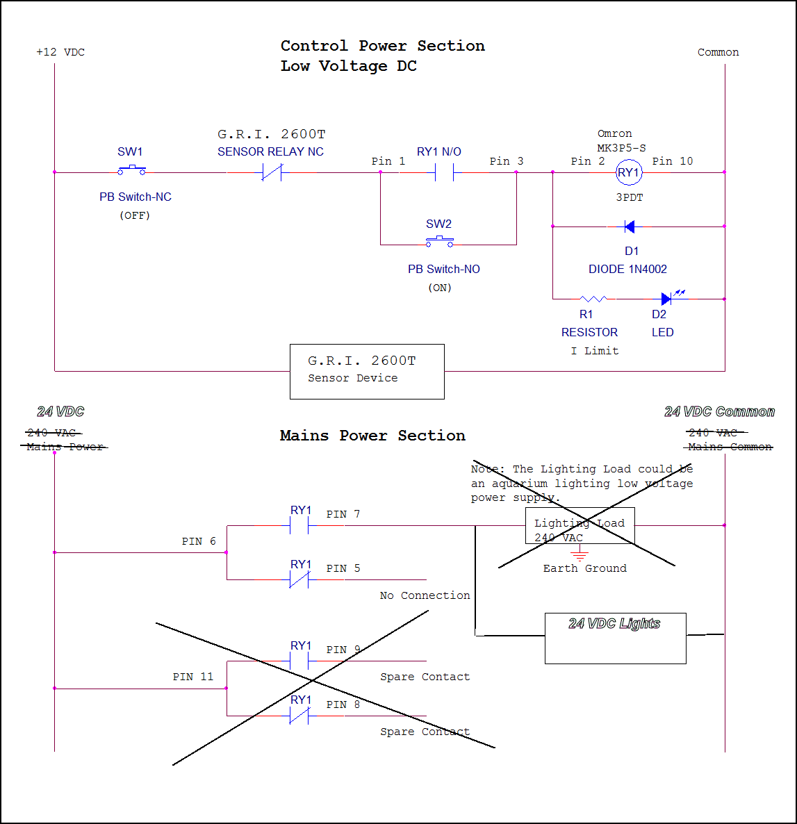

As I was building the circuit, my team mate told me that the mains power supply will be by the door so there is no need to worry about mains coming to contact with water. So, I need to shutdown the light load which gets (24VDC 5A) but I still have the 12 VDC from the power supply which is connected to the GRI2600T water detector and the relay K10P-11D15-12. One thought was to carefully build a good isolation around the relay and shutting down the water detector by having some kind of switch connected between GRI2600t and 12 VDC.
Do you know a good way to deal with this guys?
I hope I explain what I want clearly this time, other wise I could bring my friend again to explain it :)
Use the circuit you were building. The 24 VDC or whatever power for the lights will be run through the contacts of the relay in that circuit. One set of the contacts are used to self latch the relay, the remaining contacts for your load, in this case 24 VDC lighting. I can add more later if you don't understand.
Ron
Do you mean I should use one of the remaining contacts to shutdown the GRI2600t? If so, how is that achieved?
Attached is a crude modification of the last circuit I posted. The relay still shows the old pin numbers from the original relay I used. However, you should get the idea. The only change is that the lamps are powered by 24 VDC. Everything else remains the same. Mains Power as originally drawn is now 24 VDC Power.
Ron

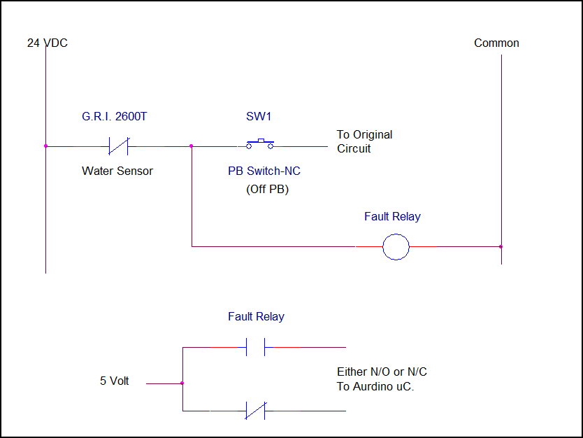

Thanks to you Ron, I implemented the circuit and it works totally fine as specified, thanks a lot to you and to carbonzit.
I am thinking about sending a signal to Arduino micro-controller when I detect water so my friend could display a special message in the screen.
How can I send that signal???
OK, let's thnk about a few things. Right now you are a student. In real life things are a little different. For example if you look back at the first drawing I did I used that relay that had 3 sets of contacts. Yes, I had it laying around but in real life I likely would have used it in a design. That way I would have had extra contacts for when someone comes along later and wants another feature in the circuit.
Anyway attached is another drawing. It is a partial of the original with a few changes. The push button OFF switch is a normally closed switch and so is the water sensor. Note that I reversed their positions. The water sensor now is first off the DC power line.
The Aurduino or any microprocessor can have a DIO (Digital In / Out) pin configured as an IN or Out. So configure a pin as a DI (Digital In) and then look at the attached. I added a Fault relay. Because during normal operation the sensor is normally closed the fault relay will be energized.
Think about it... :)
Ron
