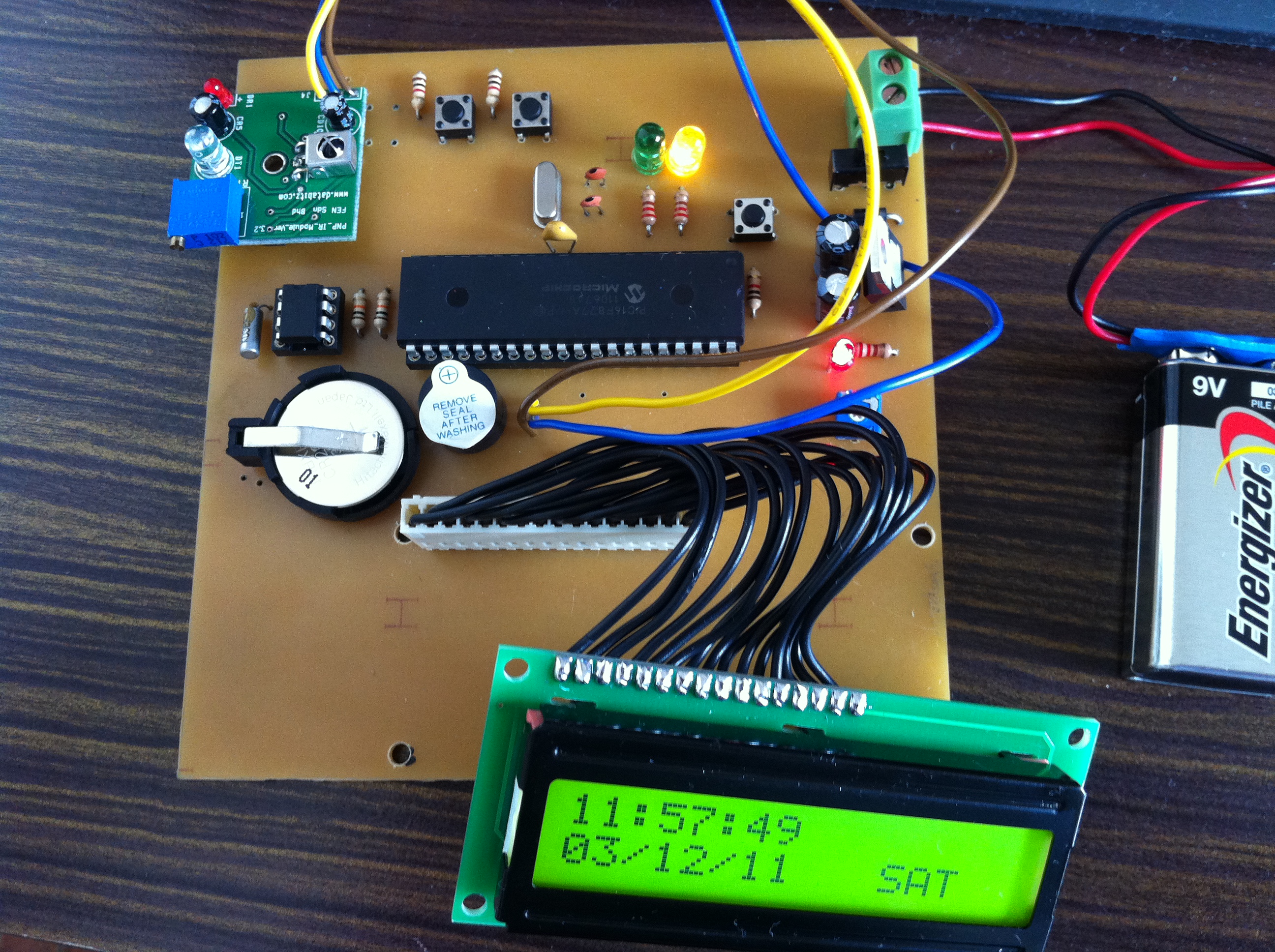

I have tried to test it just now, but seem like my rtc chip got some problem because the "hours" part shown in LCD is keep running itself. It's keep looping from 01 to 24 non-stop.
I think the rtc chip is broken, so I plan to replace it with a new one and only start to test it again.
Rusttree,these few days keep dealing with my clock.I change the rtc chip already,but the "hours" shown in LCD keep running itself.It changes from 01 to 00(24) and keep repeating and non-stop.Do you know how to troubleshoot it?Is it related to the PIC?
Three things:
1. Revert back to the original code before you added the alarm. That will rule out whether it was any changes you've made recently.
2. I don't see capacitors on the legs of the crystal on your RTC. I suspect you may need them.
3. I also don't see decoupling caps near the power pins on either of the ICs.

Hey Rusttree, sorry for didn't update my post recently because I'm busying with my assignment and test.Now I'm continue to troubleshoot my board,I have put the original code without modified into the PIC but the LCD still show 00:00:00 at first line and second line,it didn't run at all at first.
Thee is 2 LED in my board which are RED and GREEN, once I have turned on the power,the red LED will light up,it means the whole the time is running. The other one is green LED, it means it is in the set mode. When I press the switch mode button in order to adjust the time and date, the green LED will light up,so that I know it is in the set mode.
But I found that the board will auto change to set mode because at first the GREEN led will light up, after a couple second the RED led is light up, it means the clock is auto change to set mode. Can I know how to solve it?
I really don't understand why like that after I have replaced a new RTC and crystal.Previously when I put the original code on it,the clock can run well.After I have adjusted and rearrange the arrangement of my components,the clock becomes like this.
Would you mind to help me?Thank you.:)
Hey Russtree, thanks for the helps for my project. My project finally done. :)
