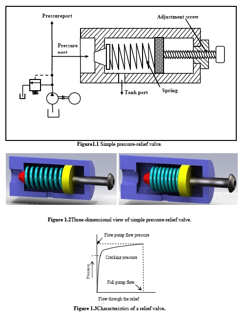

What is the function of the relief valve? What does it mean to set the relief valve? Is it set to fully closed or fully open or some other setting?

Hydraulic power steering has a pressure relief valve on the pump output, so if the power cylinder reaches the end of its travel with torque still being applied, the hydraulic pressure is limited to a safe value rather than bursting pipes or cylinder seals.
You can often hear noise from the relief valve when you hold power steering on full lock while manoeuvring, on hydraulic power steering systems.

How does relief valve know power cylinder has reached end of it's travel?
It's a pressure relief valve. It does not "know" anything.
If you kept a control valve open to a hydraulic cylinder after it has reached a mechanical limit, without a pressure relief valve or pressure regulator in the system, the flow stops and the pressure would try to become infinite; things would burst or break...
A pressure relief valve is just something like a poppet valve with a calibrated spring holding it closed, so if the pressure reaches a certain point, the valve is forced open against the spring until the pressure drops enough so the spring overrides it again.
It's the fluid equivalent of a Zener diode in electronics.
They are made in thousands of different forms for various types of fluid systems, but the principals are the same:
