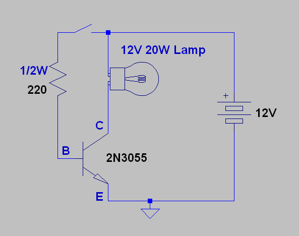

I purchased some 2N3055 transistors through eBay today and they were manufactured in India by Continental Device India Limited. It will be awhile before I will have all of the components to build the target project so I would like to know how to test the 2N3055 transistors. This is my first experience with transistors.

I'm sure the real smarty pants will have plenty of corrections for me, but when I was a young skinny person, I built a 70 volt DC supply and added a 68 ohm resistor, a switch, a 1k resistor, and an amp meter. I used alligator clips to connect each transistor up in the correct polarity at the collector and emitter with a 1k resistor from base to emitter. Turned on the 70 volts, and some of them shorted right there. Then I pressed the switch to allow 1 amp into the base, saw the meter show current flow, and let off the connection. If the transistor stopped, I called it good. Forty percent of the Mexican counterfiets failed. Then we built over a hundred multi- transistor power supplys. In the first year, 2 came back. One had a bad regulator chip and one had somebody stick a screwdriver in it and break the trim pot. The rest kept working and I never saw them again.
(Data sheet) Connected like this, the lamp should be off with the switch open, and fully on with the switch closed. The battery needs to supply ~2A. This is a basic test of the ability to stand off 12V when off, and switch 2A with a ~min Hfe of about 20.
