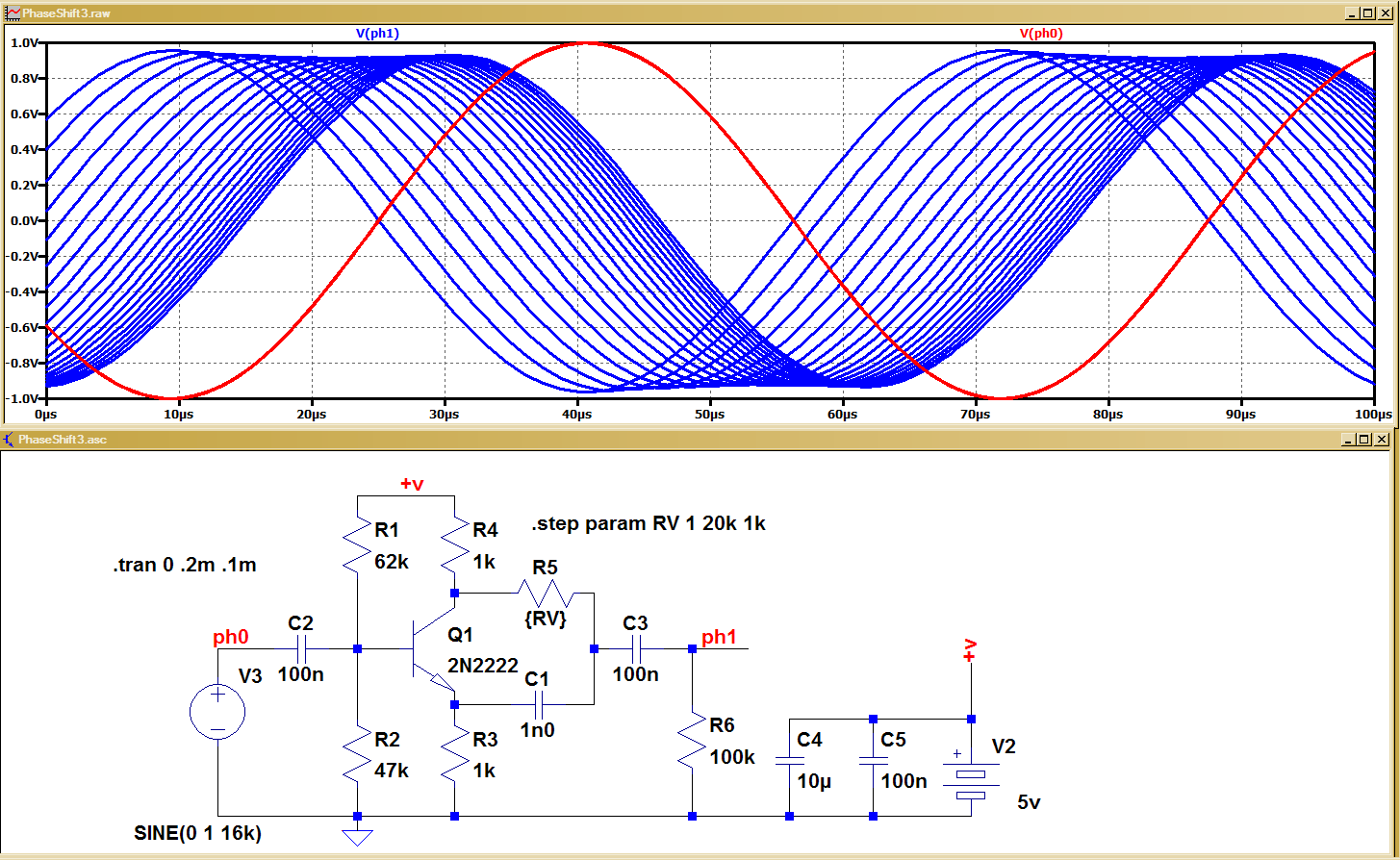

Tried this and its working fine. The only think that I changed is to use 15V rather than 12V as I can see some distortion in the rising edge of the output at 12V. This can be used into my design, but I have access only to 5V on my digital board, are there any other variations of this using 5V or should it have to be above 12V?
You asked about a 5V option.
E.
E.
Thanks Eric. I will try this one too.. I am just trying to decide which one to go for, analog or digital..... I will check which one is more reliable. One thing that I see in using analog is the sine amplitude reduces going through your circuit which is somewhat a problem for us as our sine amplitude starts from 0 and we would like to lock on it as soon as the amplitude of it changes. I hope it wont be a big problem for us, will see..

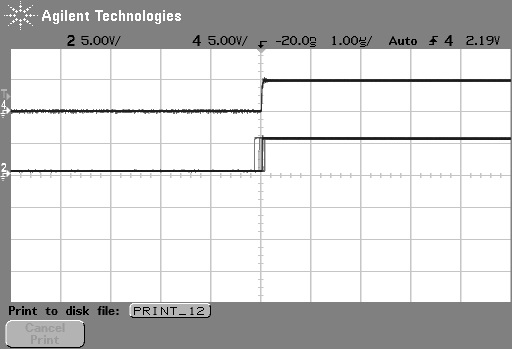

74HC4046 output jitter
I noticed something new in my PLL circuit that the output has jitter. The exact same circuit works without phase jitter on another PCB with the same PLL design. Any suggestions?
The input itself is very stable at 15.2Khz as you can see in the picture on channel 4.
