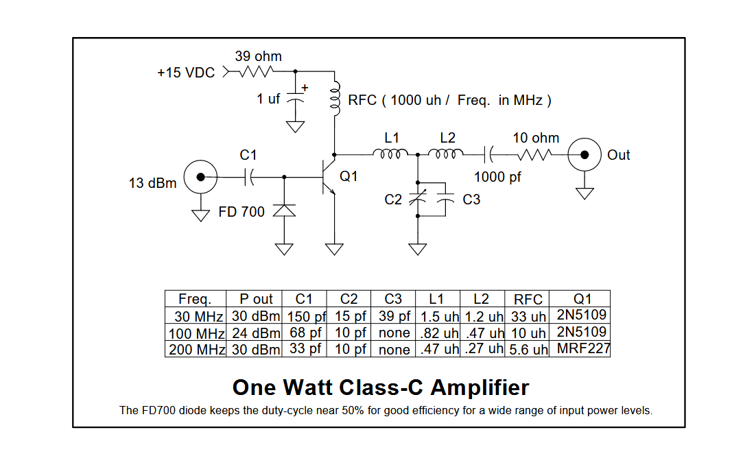

For example Class C amplifiers doesn't make sense to me since it will short to ground at DC (I get that this one at least has an resistor to prevent it). And there is no bias for the transistor itself. Maybe it is assumed that it is supposed to be used with regular AM signal so that it will have some DC bias but that would make it very unreliable. Testing it in LTSpice confirms my suspicion since it doesn't seem to work. When I add feedback from collector to base with a resistor to possibly turn it into Class A amplifier it outputs an distorted amplified signal. But it is impossible to set the Q point so that it is not distorted even with adding an emitter resistor it is always very bad at the output. Maybe the filtering at output supposed to fix it.

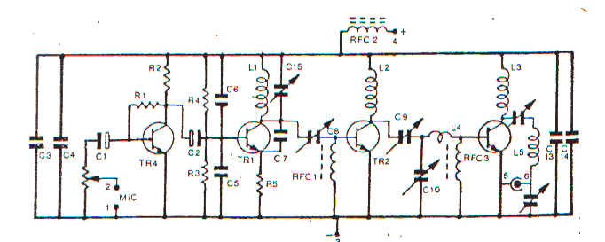

There are very weird circuits like this FM transmitter for example:
C9 and C10 should act like an voltage divider. Why is it decreasing the input signal before amplifying it. How bias voltages are determined here. How does the oscillator change its frequency exactly according to input signal.

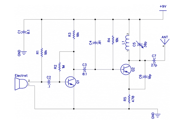

This one looks similar as well. I understand that first stage is just an amplifier and second is an oscillator but how exactly that oscillator changes its frequency according to the voltage at base. I would expect it to amplitude modulate it instead of changing its frequency.

Base V changes the collector reverse voltage which in turn changes the Ccb,
hence FM modulates a tank circuit.

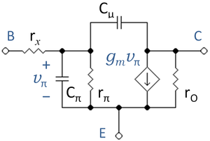

Hybrid Pi model, fairly good model for use medium RF frequencies....
Well CπCπ is mainly determined by the Base-Emitter Capacitance. This is not only the static capacitance between wires etc (which does not change much over biasing) but also the Base-Emitter PN Junction. That PN junction is a diode and its capacitance depends on the voltage across the junction and therefore the biasing conditions.
Same for CμCμ as it sits between Collector and Base and also is mostly determined by the capacitance of the Collector to Base junction. Note that this junction is reverse biased in active mode so the capacitance of that junction is highly dependent on the Base-Collector voltage.
Regards, Dana.

It is the varactor diode business all over again. Well it is just two pn junctions instead of a single one anyway. So if you add these inner capacitances with the capacitors of the oscillator, you can write an equation to determine what is the normal frequency and maximum frequency derivation. Only if I had the mental capacity to put all the information together and process it I could have designed an oscillator from scratch. Why everything in Analog realm has to be so difficult to understand. Digital is just some set states and there are no in between. I wish everything were like that.

In a nut shell:
Recall that with Class C it only conducts on the positive half cycle of the input signal. And depending on the bias level for a desired conduction angle, the period of duty cycle will vary. Usually, a point contact resistor connected from the ground to the base is used for self-bias, where the charge on the input capacitor due to the input signal creates the bias for the resistor. This idea comes up from the vacuum tube days of using self-bias.
Here is the best video on self-biased Class C amps. It explains the relationship of the input capacitor with the bias resistor. It would be good to watch all of this video and build the circuit in Spice (LTSpice).
For precise bias settings, for particular conduction angles on the positive pulse, the bias needs to be set using a conventional bias voltage divider. Which is more stable when you think about it.
Now to restore the negative half cycle, the signal on the transistor collector needs to go to a resonant tank circuit, where via the principle of the fly wheel action of resonance, restores the negative half cycle.
Your idea of feedback from the collector to base is not a good idea since this can lead to a parasitic oscillation.
