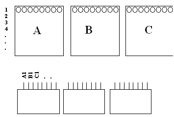

Each matrix must be the right way round.... I haven't got the circuit to hand but A,B,C etc are at the bottom and 123 etc at the top
YOU MUST change the properties of each matrix in ISIS to "NOT INVERT"
Are you using the same shift registers that I'm using?
One other thing.... I didn't mention the order of the shift registers...
The scan is row by row... When I say row I mean complete row all four matrices..
This way I can use the memory as linear... Perfect for drawing..

I'm not!! I'm using row scanning.. The ISR doesn't need to change as there are as many rows as columns...
If you are using your old display you would need to change the way you write your data to the buffer..
I scan a full row... You scan a full matrix..
and how are you feeding serial data??
There is no serial data... I feed all 8 led's in a single row from portb
All I do is ground the leds row by row...

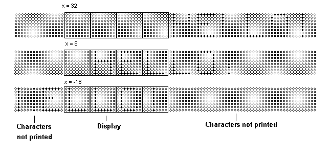

I WAS going to use a union... But I though if we did a basic scanning system (Row scanning was your idea ) You could animate the screen FAR FAR easier than you have been doing..
Let me explain.
Once you are scanning the complete display, just the same as your computer scans its monitor, From left to right from top to bottom... Most imaging software creates their images this way..... All you need to do is paste the image into a buffer... You need this for speed as virtually no image processing is needed..
I have implemented a technique called "clipping"... Any pixel outside the drawing surface isn't drawn... This way you could have a larger picture than the display and scroll up, down, left or right just by changing the initial x,y value.... You can create frames in "Paint" and use that "FastLCD" program to create your binary images... Then you can blit your backbuffer to the displaybuffer in milliseconds... creating any animation you want.... If you create a string ie... "Hello world!!!"... This has 14 characters 14x8 pixels or 114 pixels long.. If you print the string to the buffer... ( clear the buffer first )
for(i=32;i> -96;i--)
   clr();
   strput(str,i,0);
   blit();
   __delay_ms(100);
The first character STARTS at 32,0... "Off screen" so none of the rest of the string is printed..
When "i" becomes negative, all the pixels negative are "Off screen" so they are not printed, all the pixels positive will..
That routine above will print the string, in full, across the display but only the pixels that fall in between 0 and 31 will be seen!!!

Take a look at my scroll logic... This is a snapshot of x at 32 then at 8 and lastly at -16
The four matrices are highlighted...
The string "HELLO!" is first printed at 32,0 so nothing appears as every pixel is outside the display area ( clipped).
The string is then printed at 31,30,29.... and you will only see the partial string...
As you can see at position "8" the letters "HEL" are visible.... And eventually at -16 you can see "LLO!" ... Quite simple really.
OK, x indicate the number where the display is starting.....

Aha!! You are very observant!!... Look at the shift register outputs.... Each one accesses the rows in turn.
The first output ( Q0 ) is connected to matrix row 1
The second ( Q1 ) is connected to matrix 2 row 1
The third ( Q2 ) .... third matrix row 1
Then ( Q3 ) ... forth matrix row 1
BUT THEN!!
(Q4 ) is connected to the first matrix row 2
.. so on....
The changes needed were in the hardware...
