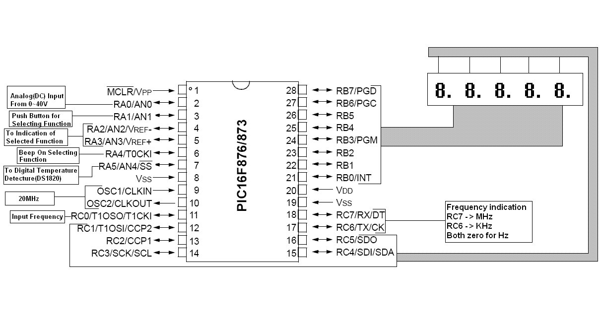

How we can do it in Assembly..Help Needed
Found label after column 1. (RLF)
error during build.
help needed.
In my view, RLF is an older command. cuz when i write in MPLAB it color does't change in blue.
You need to supply more information. Try posting all your code and explaining exactly what you are trying to do. Posting random questions is just wasting everone's time.
P.S. this is starting to remind me of Walter.
btfsc INTCON,T0IF
goto INT_TMR0
movfw SEGMENT; move segment to working register
sublw .32; subtract decimal (.) 32
movlw .2; put 2 into work register
btfss STATUS,C; test is w was more than 32
movwf SEGMENT; if it was store W in segment
Plz explain this, u write it in ur previous pose on page 1 of this thread.
how a carry will be gernate
Please study the data sheet and the above code until you understand how it works.
Both picture and code are not completed

This is the code.
It's one part voltage calculation is completed.
Other parts remaing( temperature measurement, frequency measure ment etc)
my orignal picture is not like this, my orignal picture is different from it.
I will share it later cuz that is in not completed yet.
