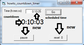

first of all a salute to ericgibbs for their great collaboration and time to my questions.
timer with start, stop, reset, programmable countdown.
I want to enter a time to do the count back, but if you count only income just normal time
I have good and much of the source code in visual basic 6 help I wish to correct or add more details to this timer as the web did not find much help I hope their contributions thanks for taking the time to read this post.
Greetings from Colombia.
thanks
attached a picture of how I want the timer and a zip with the source code in visual basic
good is my first post hope to do well
and I apologize for my bad English

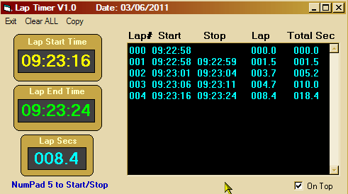

Look at this option, all in the zip file.
EDIT:
As you are interested in timers, I have added a second zipped VB file
  • ivan1.zip
  • timer2.zip
hi there look at this another example
hi there look at this another example I want the time you enter is fijaen but make the text in the label off, but this example has a small inconvenience when I start counting again, does not break as the first thing you mostre.
the problem is in the variable m_StopTime = Now
time_now = Now
  • howto_countdown_timer.zip
