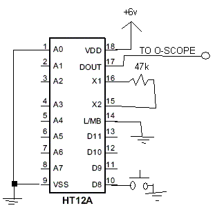

I just got my HT12A and HT12Ds in the mail today and am trying to get the HT12A to work first because without an output signal from the encoder how can i get the decoder to work :lol: ?
Anyway I have the HT12A wired up exactly as in my crude drawing. I have my o-scope hooked up to the DOUT pin. Strangely enough, the only thing that hapens when I hit that momentary pushbutton switch is that the output latches and goes high.
What am I doing wrong??

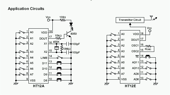

i think your chip doesn't oscillate. you wired it like HT12E instead of HT12A. so change the resistor from 47k to value shown, add crystal and two capacitors. that should do it...
  • ht12a.pdf
I thought that was just because it was being used as an IR transmitter. The crystal setting the precise frequency. Well that does clear things up a bit :lol:

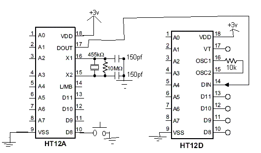

I cannot get the output of the HT12D to go high when I press close the input on the HT12A. Included is a schematic of exactly what my circuit looks like.
As a quick thought, you've left all the address lines floating, I don't know what effect that might have, but there's certainly a chance that this may result in them both being set to different addresses.
Also, is the input the same polarity as the output?, they are intended for IR remote control, and the remote receivers invert the data.

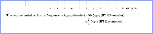

The data sheet of HT12D specifically mentioned that OSC freqiency of decoder should be 1/3 that of HT12A encoder. 8)
oh dear, theres my problem :lol: . I skipped right over that. Sort of a funny place to put such an important thing.
I don't think so but ill make sure of that. The waveforms looked the same on my oscilloscope. Of course I couldn't compare them right next to each other because I only have one probe for now.
Yes, the input is negative, the output is positive.

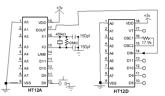

Made some changes. These are the frequencies that the chips are operating at:
HT12A- 434.7KHZ
HT12D- 144.9KHZ
434.7kHz/3= 144.7kHz. the HT12D is oscillating @ 1/3 of the HT12A.
I also connected A0 on both chips to ground like Nigle mentioned.
One thing that I noticed is that the output of the HT12A does not oscillate as fast as the actual oscillator (X1 and X2). I did not bother to measure the frequency. Am I supposed to make the oscillator frequency of the HT12D 1/3 of the output of the HT12A or the oscillator of the HT12A?
I am still not getting any kind of output from the HT12D. I think im doing everything right here.

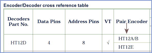

The HT12E will work with the HT12D. And yes, actually the HT12A will also work with the HT12D, i was wrong on that one.
Take a look at this .pdf. It shows the HT12E working with the HT12D.
Another reason I am going to use the HT12E is because it requires less components for its oscillator; one resistor. The HT12A uses a resistor, two capacitors, and a crystal.
